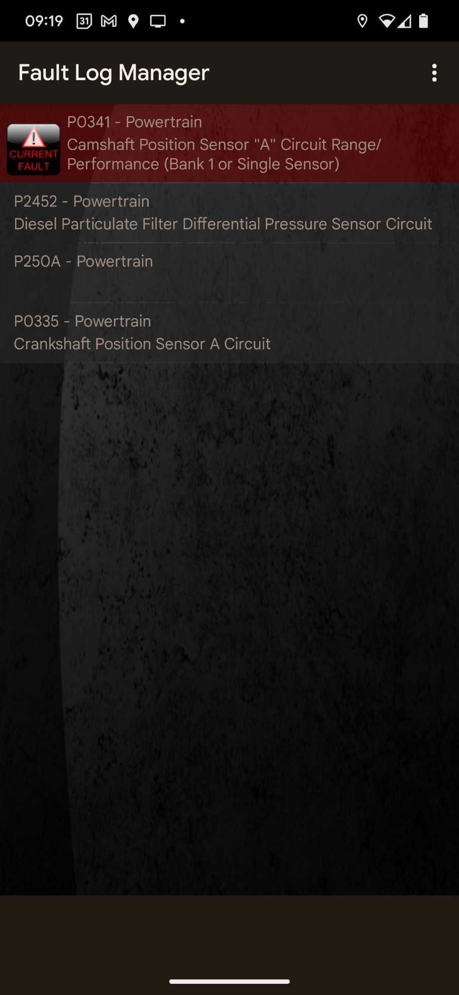

I have a message on the case (camshaft position).
The sensor has been changed
Besides, it can also start without the AAC sensor.
Have you had this trick before? Can you guide me on another track?
I have 5V voltage at the sensor terminal.
PHOTO sensor voltage
- By that of the old engine, same result
- By that of the same volvo, same result
- By a new sensor, same result
