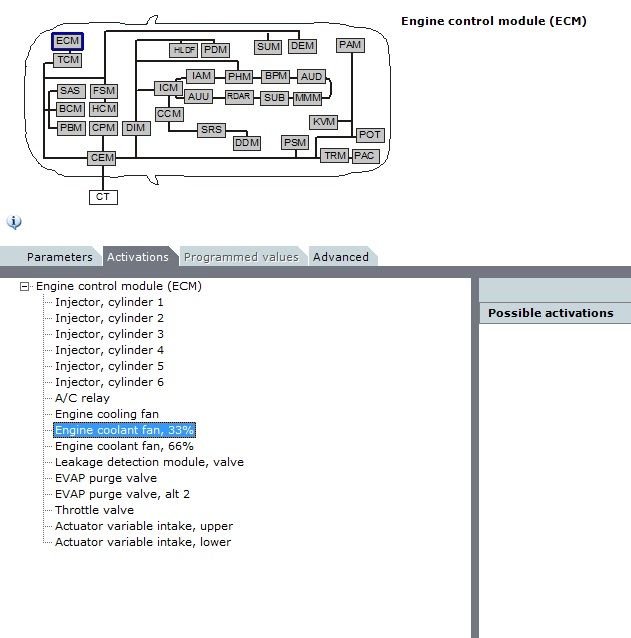

If the engine gets too hot - the compressor will shut off also. (due to a fan not working, or broken thermostat for example) Did you get that code from VIDA? If so click on the code for this diagnostic info. A good scan tool can activate the fans for testing - as shown below also

Hmm interesting. I only have a basic bluetooth scan tool and phone app - am I correct in interpreting the above as a possible binding fan? Or failing fan? They both seem to work as expected - I can see them spinning and they change speed depending on the temp. They also keep the car at ~93 C in hot traffic which is roughly what I would expect. I don't want to replace them unnecessarily but equally don't want them failing on a long trip.
