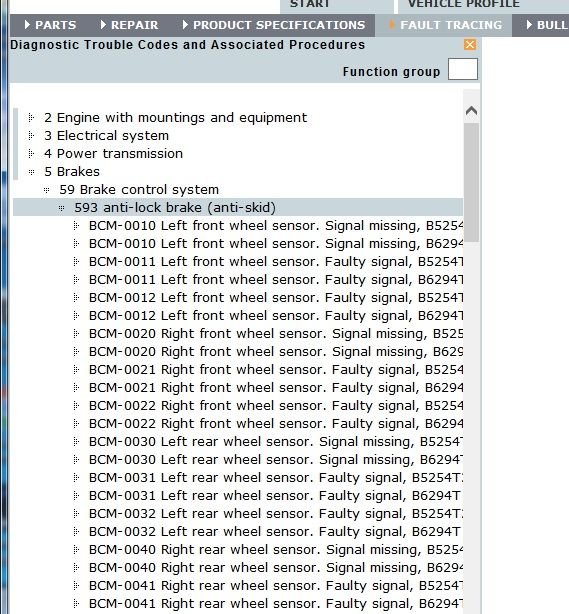

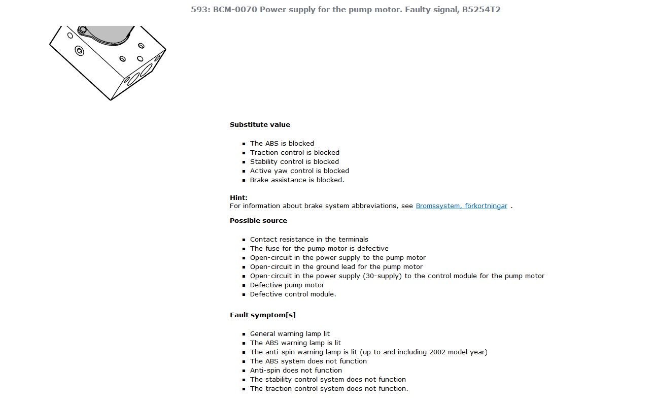

You have Vida - click on the code and it gives you this info - have you followed those diagnostic paths? that's what i would do.

You don't have to connect to the car to get that info - it's under "information/fault tracing/diagnostic trouble codes" - then find the system and the code -
