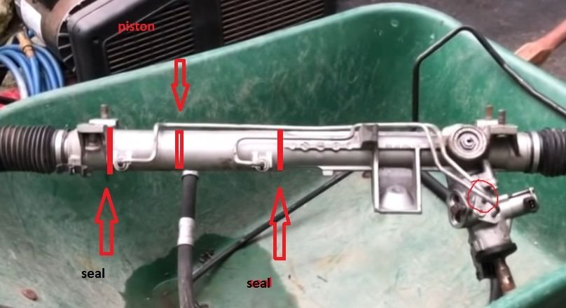

I looked at things a little more and it looks like the leak is actually from a line that goes from one side of the rack to the other. I attached an image
https://mikkowus.com/steeringRack.png
leaking line

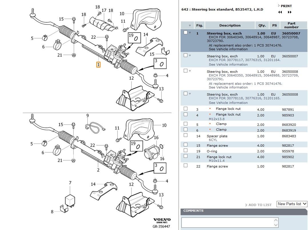

Volvo does not sell those tubes. Those tubes carry fluid under pressure to push the piston back and forth between those two pipes. - Most likely the solution is a different rack. Unless the pipes are sealed by item #19 on the control side.

Thank you. I'll order that O ring. Maybe I'll have some luck.

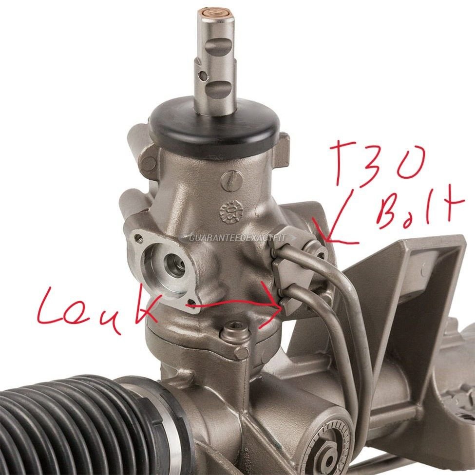

Originally Posted by hoonk
What holds those tubes in? There's a threaded fitting on the rack end, what's on the other end?
There is a plate that slides over some lumps on those 2 small lines. That plate is held down by a single T30 bolt. the bolt is kind of far away from where the lines go in so I don't think there is enough pressure holding that plate down. Or, like the Mechanic said, The original O ring was dried up and he cant find the right replacement O ring.
I would almost bet he did something dumb like not torque that bolt down, and then when I brought it back in, he just replaced the O ring as a way to cover up, and then he couldn't find the right size after throwing the original O ring away. The last time I brought it in he didn't put the splash guard back on. It's still at his shop if he didn't toss it. I need to call him up before he does. Everybody has been overwhelmed with work lately. He's usually really good, but could be screwing up because he's so overworked.
Another possibility is the line is somehow damaged going into the steering rack so the o ring just doesn't seal it properly. If there was more space, or I had a lift I might be able to get in there and have a look see but right now its pretty hard to get my hands in that space.

The leak seems to come from the lower line only and Its pretty significant. One thought I had was maybe I could put some kind of clamp on the opposite side of that hold down plate to help hold those lines in a little better. I just am not sure what I could use. Maybe a perfectly sized c clamp with some of the threaded part cut off?

It looks like there is a crack in the top side of the lower lie, just on the outside of the flange that the plate that is screwed down goes over. I put a O ring over the top of it and a bunch of gasket maker, hopefully that holds up for a few days and the new lines come quick.
