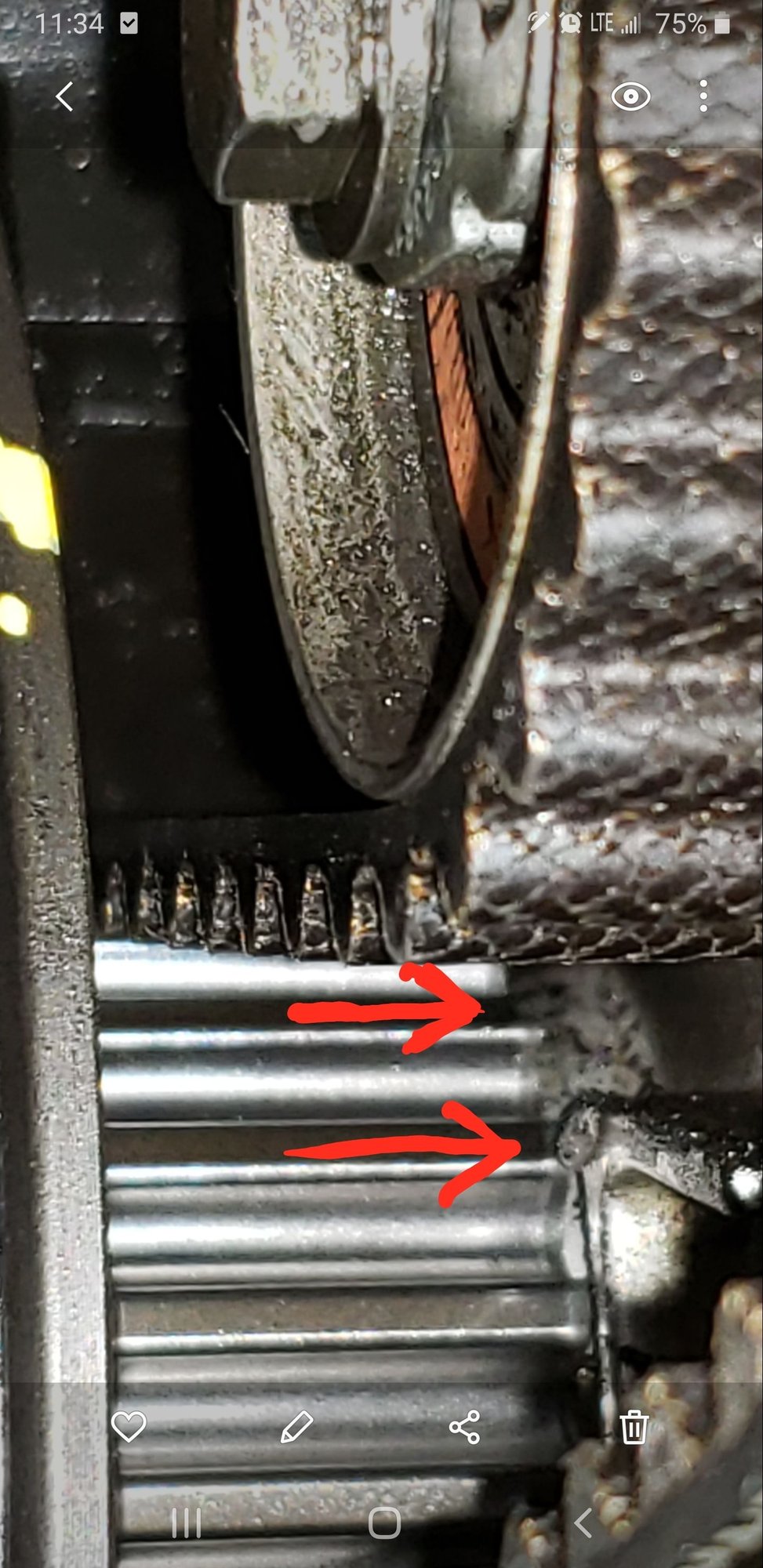

The main concern is, I believe the crank shaft may have slipped one or two teeth counterclockwise. I placed a cam locking tool on the cams when I initially turned clockwise to TDC. I then tried to use a pry par to loosen the crank pulley nut off and the timing belt tensioner released tension and the crank moved counterclockwise. I am still able to turn the crank by hand with the timing belt and cams. So here are my questions...

5. Can someone look at a photo of my pulley position and see if its off. (I'll post a photo later)

Currently the timing belt is still on.
The cams are in the correct position.
The crank is off by 1 tooth counterclockwise.
How do I turn the crank back into the correct position?
Do I need to take the T belt off and then turn the crank?
Once I remove the T belt, will the crank not move due to the cams being in the correct position and the pistons have compression?

The markings are lined up with the cover. I was trying to remove the crank pulley nut, with a cam holding tool then the T belt tensioner gave slack and the crank slipped one tooth.
So can someone tell me if the crank will turn by hand 1 tooth if the belt is off?

So I was able to loosen the belt and get everything aligned and turn over by band without valves hitting. I was able to get the crank nut off by using the cars starter then use the air gun. I got the flywheel and timing pully off too.
What is the best approach to get the timing pulley back on?
How would turning the crank feel if valves were bent? Would it just not turn?
