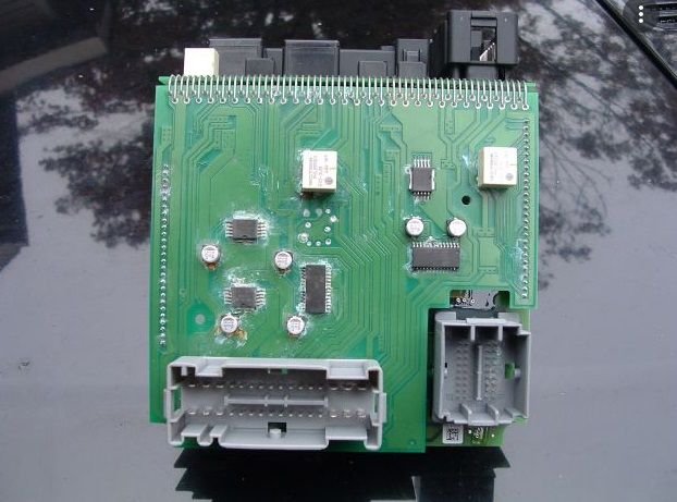

Here's a common CEM failure - due to water leaks.

My CEM looks flawless. Really. There is absolutely no sign of water damage.

Or this one, plug looks not too bad, but corrosion on Integrated circuits. Have the car scanned with Vida, and get a print out of that scan. Any independents around that will do a 1/2 hour scan with Vida? You need codes to be able to formulate a diagnostic path. What part of the country are you?
