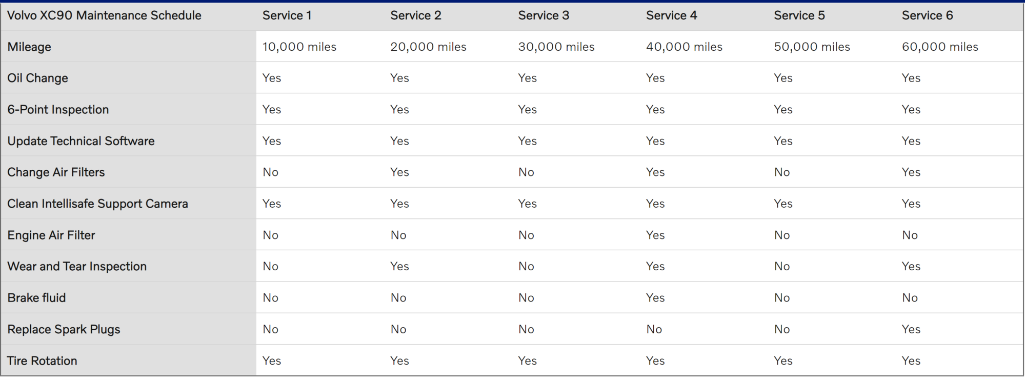

Found this on a Volvo dealer site. No reference to Transmission Fluid but good reference material
Maintenance schedule
