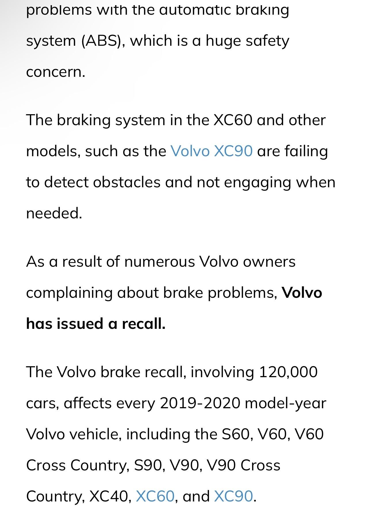

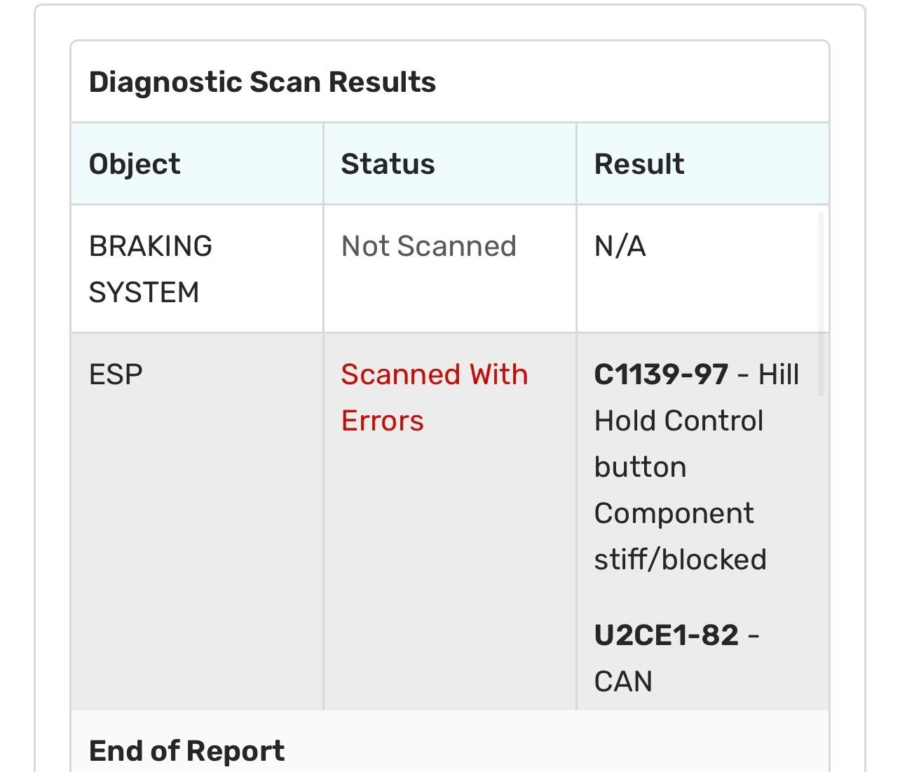

I know this is 9 months later but Volvo did a recall for this. I’m not sure if the recall fixed the issue or not. I have a 2018 XC 60, low mileage and have to replace them every year. This time it lasted 2,500 miles. 2018 didn’t make the recall but there’s no way this issue is a coincidence. I also had diagnostics done, and in hindsight, it seems odd they (Volvo) didn’t scan the brake system.
I took my car to a non Volvo mechanic yesterday and he believe the brake system is failing.
Just wanted you to be aware in case you’re still dealing with this.
