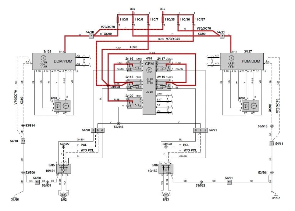

I'm currently troubleshooting the driver side power window in my 2004 XC-90. 2.5L, Turbo, AWD model. I think I've narrowed it down to the relay switch, but I don't know which one it is, and what its exact location is. Please help!

There are no relays for the front windows - there are up and down relays for the rear windows on the CEM - 2/116,117,118 and 119. 2/120 is a relay for the power child locks. You probably have a bad switch, known as the DDM (drivers door module.) Some of those require a software download to make them talk to the rest of the car and actually work.
