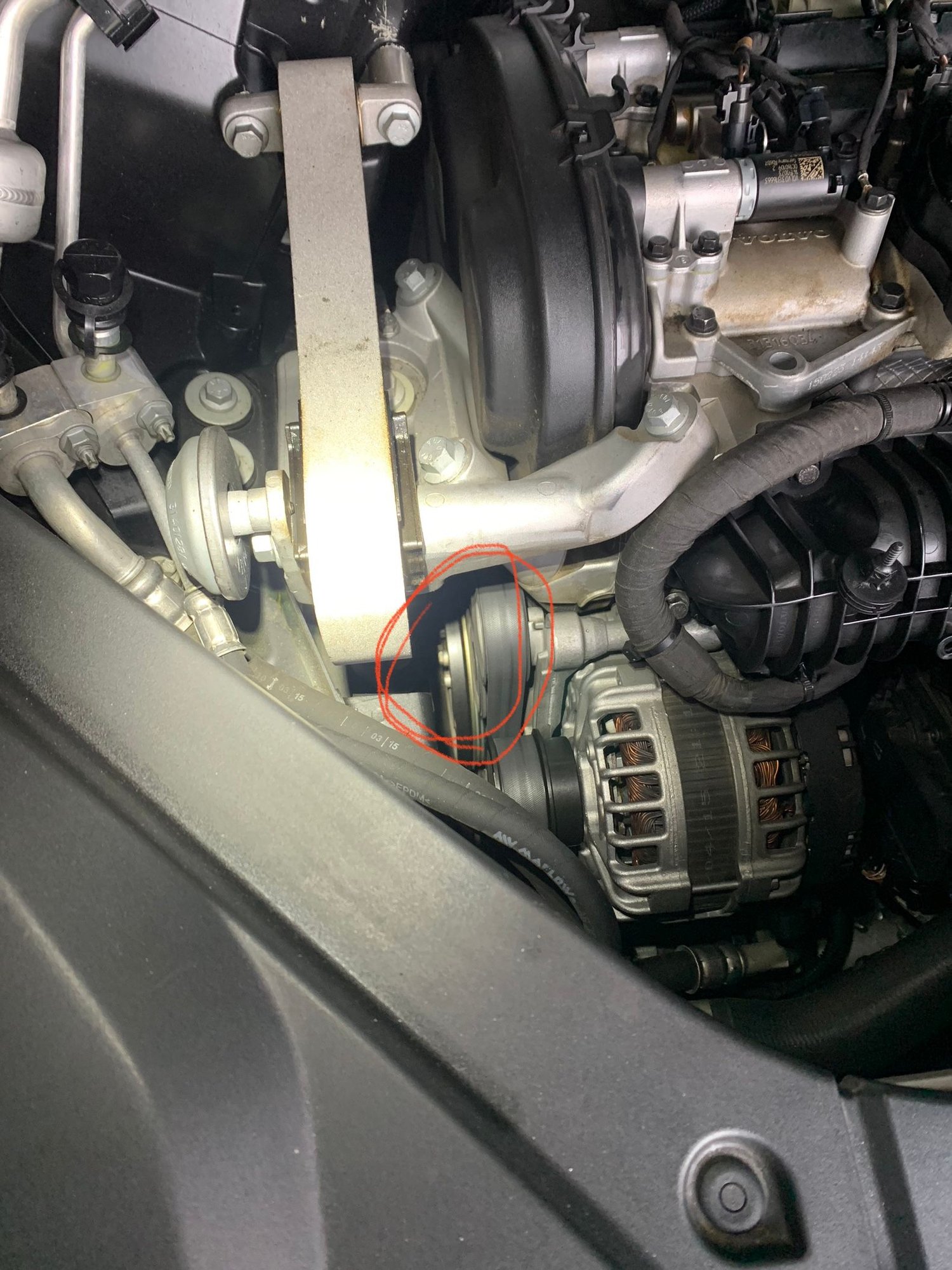

Back to initial question, shall I put socket onto to drive pulley or need to find flywheel first? it’s a 2.0T engine

drive pulley meaning the bolt in the center of the harmonic balancer on the front end of the crankshaft? that should work since that bolt is torqued down pretty hard (lol, just try removing it :-) ). if the plugs are out you may be able to rotate the engine using the accessory belt since there's no compression resistance. (but I've not tried that on a Volvo... )

As the space is very tight, not sure how to put in a wrench into and do I need to remove some parts to get more space? Not straightforward as any Japanese cars
