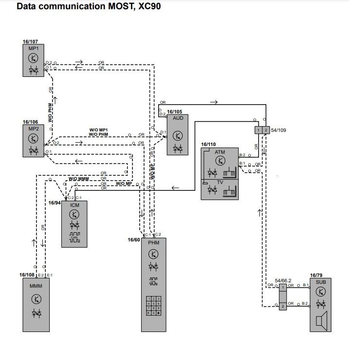

I would like to upgrade the radio with Android Auto though. I saw a few options on Amazon or ebay. But they may not be compatible for all xc90. Mine doesn't have navigation, does have a speaker screen (and a speaker below, I assume?) at where the factory navigation would go to. It has rear entertainment system but may not have Aux (I didn't see it yesterday). And the CANbus might have something to do with the setup from what I found and there are multiple versions? So what are my options? Any suggestions would be appreciated. Thank you.

For the message your first step would be to scan the car with a compatible scanner - then proceed with a reasonable diagnostic path. A common problem is with the ABS control unit - bad connections in it require repair or replacement.
The Infortainment system will be complicated to replace. All of the components of it work by communicating over a MOST (fiber optic) bus. Replacements in xc90 I've seen usually have the control screen still attached and hidden under the passenger seat, with aftermarket stuff rigged into the system. You can find wiring diagrams at volvodiag.com
Your car probably won't have the PHone, subwoofer, or mp1 and 2 modules.

Thank you. That's very helpful. You are right. Mine doesn't have phone, MD or subwoofer. I will look into the radio upgrade. Some systems in Amazon look very simple and elegant. I know they probably won't work even though they say they would. I'm going to give them a try. At worst I return them.

Finally upgraded with an Android head unit with Android Auto and Apple carplay on this non-AUX XC90 about 2 months ago. Very happy with the results. Also fixed the anti-skid problem this week. Now the AWD is back and running. No mechanical or electrical problem with the car any more.
