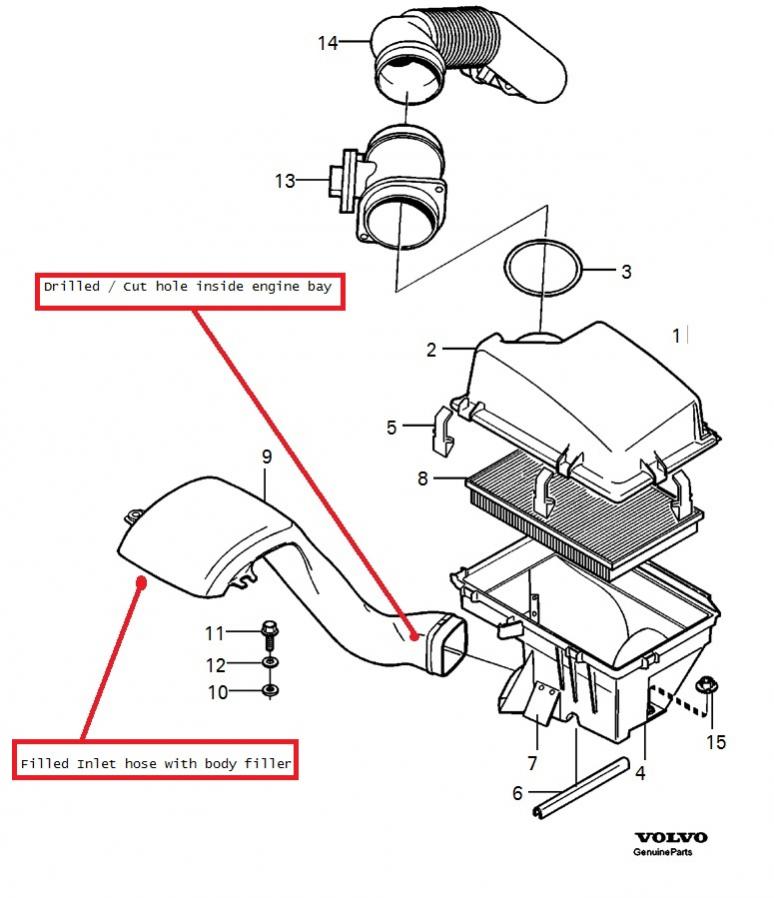

hello everyone , just looking for an opinion on my latest discovery left by the monkey botch job mechanics , there seems to be a problem with my air inlet / intake as there is a big hole where there is not supposed to be on the inside of the engine bay also they have filled the inlet / intake with body filler i want to know as to why someone would do this , to my way of thinking they didnt want to pay for a new MAF sensor so thought this up to regulate the temperature which hasnt worked as now my engine is roaring and has no power , here is the image below any information would be greatly appreciated

A hole there will not effect MAF readings. I have no idea what they were trying to do

is the check engine light on? if so get codes pulled. this was really a hare-brained repair. i would replace that intake tubing and replace the air filter. what were they trying to fix anyway?

Yeah replace the pipe or at least get the body filler out if possible. It's probably starving for air.

As for that tube going INTO the air box. That tube helps the intake system get cooler, fresher air. Anything prior to the air filter is not as big of a deal as tubes after the air box. Just get that tube replaced, not big deal. Wish I could help with your misfire but it sound like you have done most of the trouble shooting already. What were the compression numbers like?

thanks for the continued feedback, ive just fixed the air intake last night i had to hacksaw the plastic cap that someone had glued on the end and fill the makeshift hole with body filler should do the job for now untill i can source a new part from the scrappy
also the mechanic i use didnt touch the air intake that was done by someone else who owned the car prior

ok guys quick update i refitted the air intake after fixing it best i could, went outside this morning -4 and after 3 seconds the car burst into life and the engine light has now gone ??? could this possibly be what the problem was there is a slight power increase aswell as the engine being slightly more quiet
