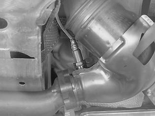

2006 Volvo XC90 4.4l V8.
Rear, right (passenger side) HO2S metal disk. It this disk supposed to look like this and be up against the exhaust header pipe flange?
Thanks in advance.

You can bend it up a little if it's rattling or something.

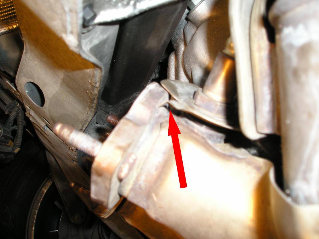

Thanks for the response. I can't find any pictures anywhere that shows these disks installed on bank 2. Bank 1 has no disks at all. Mitchel1 has the photos and the disk is not installed. Are these disks necessary?

They show up in the parts catalog. There are two different ones. One is called "Protecting Plate" and the other "Heat Shield"

Well, I guess that I will reinstall them then. Thanks for the help!
