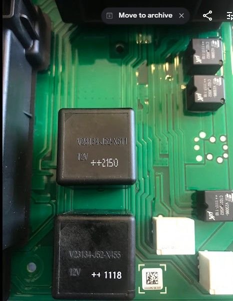

My issue (no power on passenger seat and front/middle cigarette lighter/2012 XC90) got fixed by replacing the relay on CEM under the hood. The model I used isManufacturer:
TE CONNECTIVITY
Manufacturer Part No:
V23134J0052X511-EV-CBOX

Thats a new angle, what number relay is that?
You can see the new one is on the top.

It's also under dash, but I need open the hood to remove a vending part to remove CEM.
Maybe it is different part version of the relay you used?

Originally Posted by Volere
Ok, are you saying I used the wrong spec relay?
Can't tell if that's the reason or not. These are same 12V and 70A, only difference is the version,
511 has a resistor and 439 uses a diode
