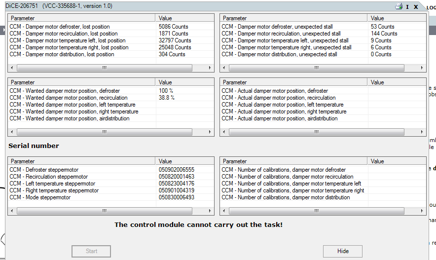

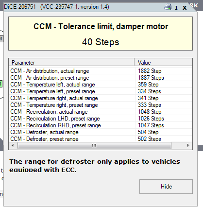

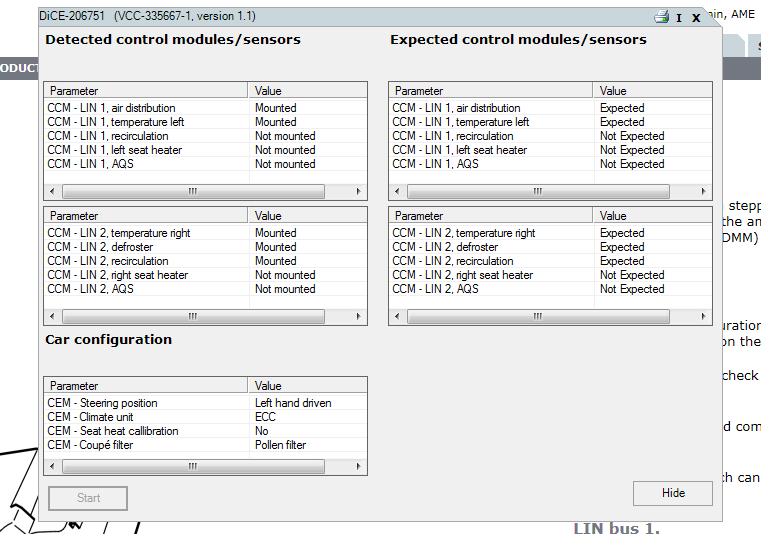

Here are the readings from VIDA. I think if I knew what it means I would be able to fix it. Could anyone explain how to proceed from here?
