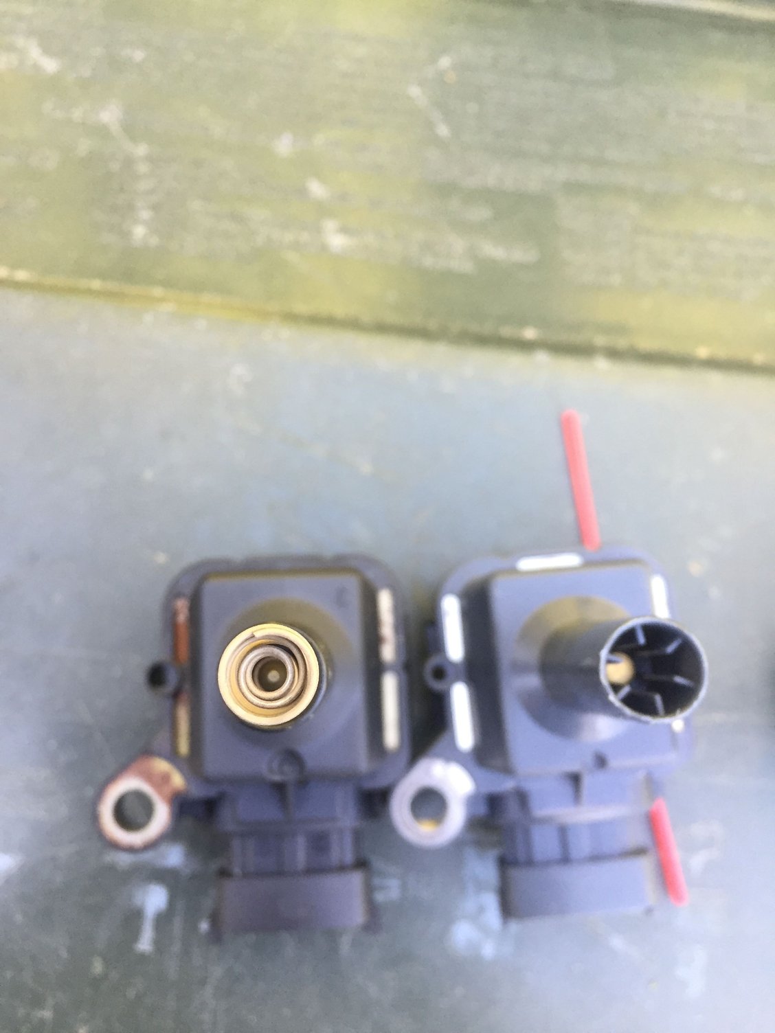

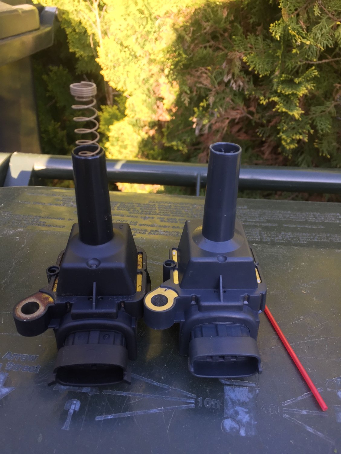

Those look like what I have. I guess I didn't describe it well.
This is with the boot off.
It's not the best view, but you can see the tip of the cone-shaped thing on the left and where it's missing on the right.

The one on the right that has the pin and then spring needs to go into the trash. Buy some that have the spring attached to the end of the coil securely.
