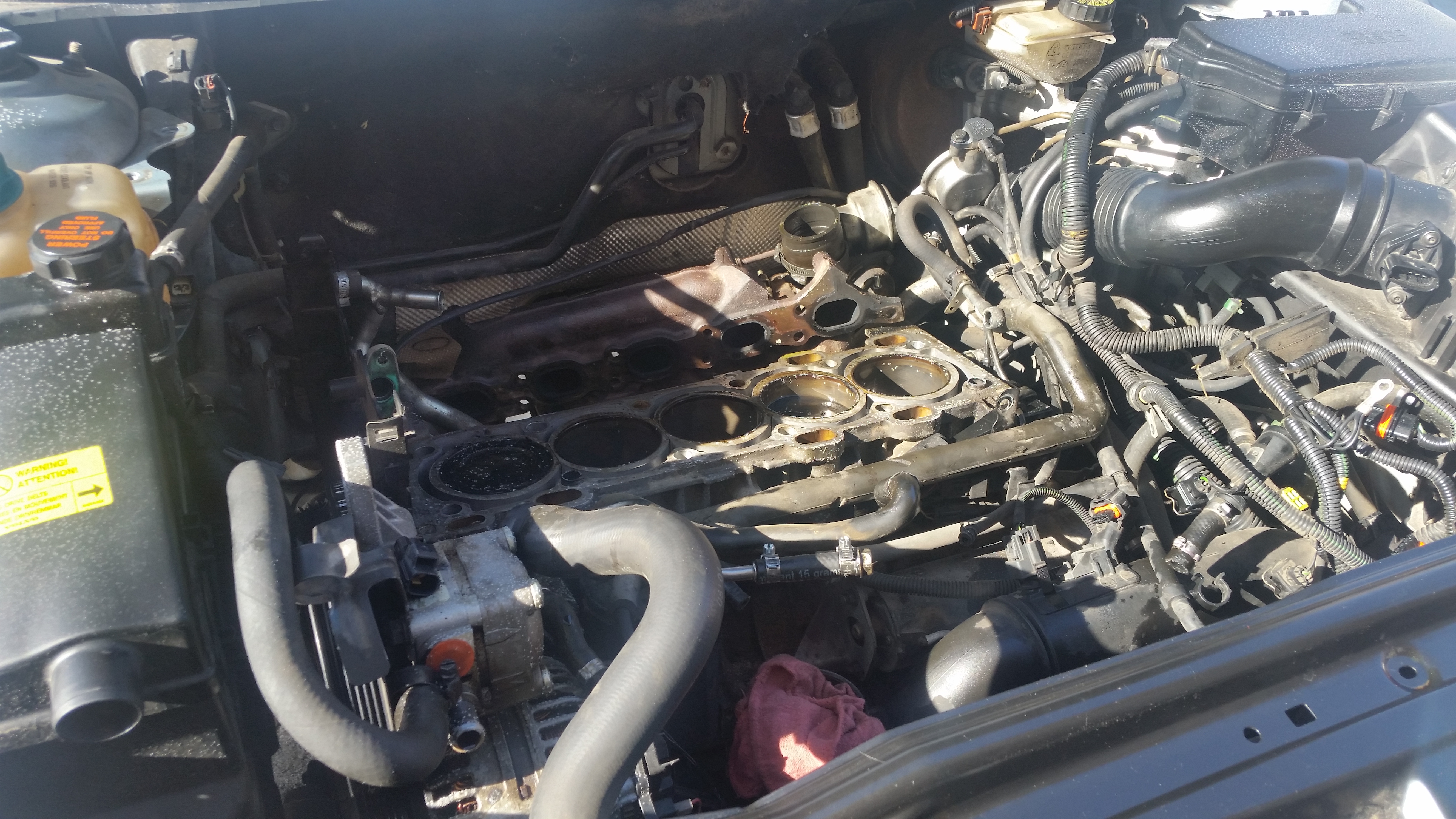

I am the proud new owner of a beautiful 2001 V70 XC 2.4T 165Kmi
This car has a really clean black interior with heated leather seats. Does this mean it has some sort of premium package or do all XC versions have all this luxury? I really like the car, but I have to say my favorite part is the price I paid for the car, 0. Free. Nothing!
That's the good news, lol. The Bad news is that I had to tow it home with half of the engine in the backseat. The story goes as follows:
Previous Owner is the original owner. It was in some sort of minor accident in which the radiator was damaged. The car was repaired at the body shop, but nobody noticed the radiator was damaged right away. It was driven and overheated at least once. The radiator was then replaced. After that, the previous owner was experiencing overheating and coolant loss (Head gasket). They took it to a local shop (not a volvo mechanic) to have it repaired. The shop determined the cylinder head was warped beyond re-surfacing (0.012").
They decided it would be too expensive to repair and offered it to me for free.
I have lots of home-mechanical experience. Including Cylinder Head removal and head gasket replacement on other (not volvo) cars. I'm not shy about getting my hands dirty. I don't have any issues with this project except that because I didn't disassemble the car, I will be confused at where everything goes, especially hoses and wires. I am hoping by taking pictures and using this forum, I can get it back together.
I am planning on getting a re-manufactured cylinder head from odessa cylinder head. Does anybody have experience with them? They seem to be the only place that has 2.4T volvo heads in stock. I have used a reman head on my Honda and it's still ticking 50k+ miles later. I'm planning on fabricating the special volvo tools.
I wouldn't bother doing this repair if the car wasn't in such good shape and so well maintained.

Attached Thumbnails New Volvo Owner. Need help with Project.-20170129_104551%5B1%5D.jpg   New Volvo Owner. Need help with Project.-20170127_083240%5B1%5D.jpg   New Volvo Owner. Need help with Project.-20170129_105801%5B1%5D.jpg
