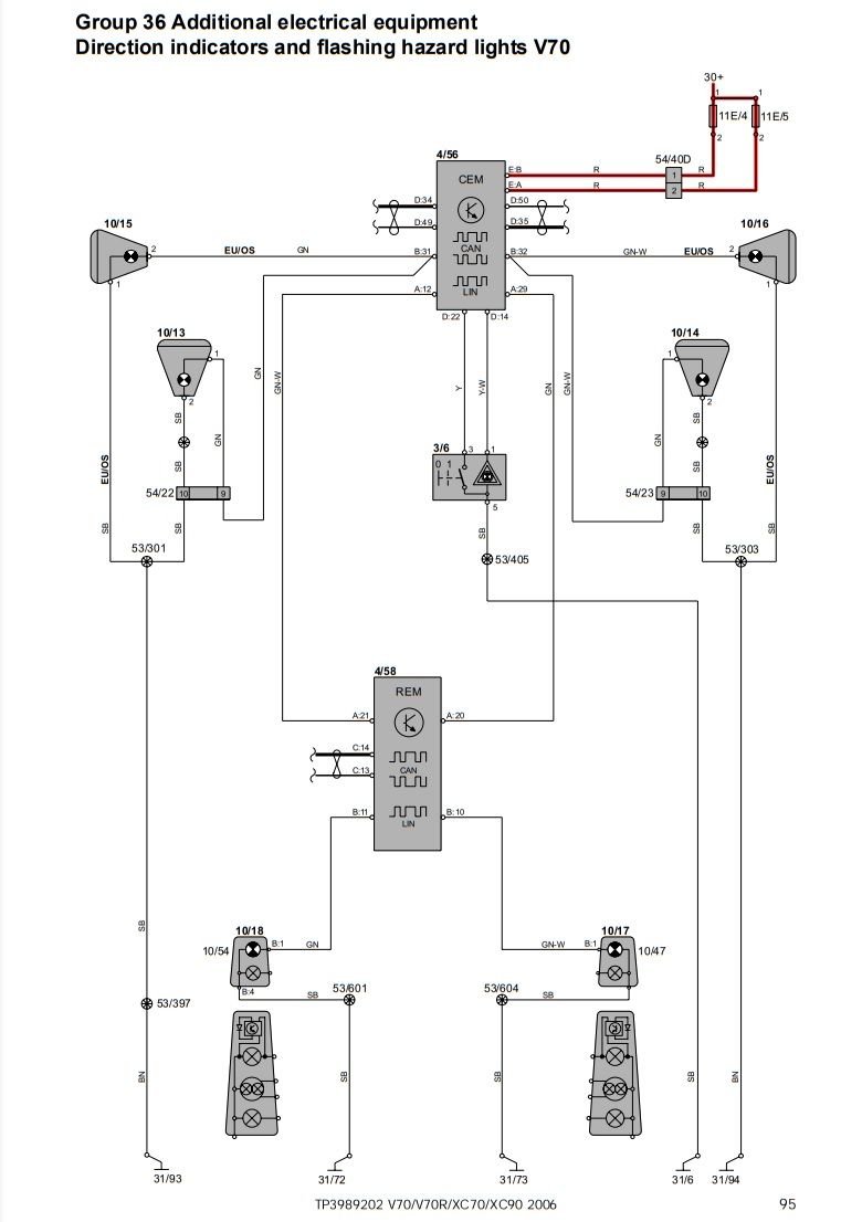

Here's a wiring diagram for the ts/hazards. 10/14, 16, 17 are the three right turn signal bulbs. Front, fender and rear. 3/6 is the hazard switch - note no turn signal switch in the diagram - the signal comes over the can bus from the steering wheel module. If you are thinking - Hey how about those 2 fuses e/4 and 5? Maybe that"s left and right ? No those are 50 amp fuses in the fusebox in the trunk next to the battery and feed all sort of other systems. I'd vote for a water damaged CEM - any CEM codes? I trust someone has scanned all the control units.

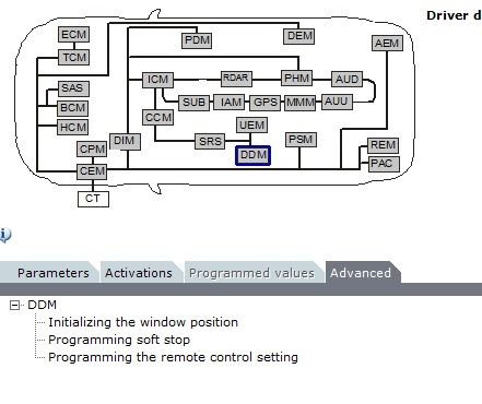

With VIDA and probably any quality scan tool you can talk to the REM and tell it to lock and unlock the rear half of the car, doors, tailgate, gas door, power child lock (if equipped) - has anyone tried that?
I trust your Volvo shop has a scan tool capable of talking to all the modules in the car. What codes are stored? Have they tried to set the auto down windows for you? Just takes a minute once connected.
This is the screen in VIDA where you can fix the windows. A quality scan tool should be able to talk to all the modules installed in your car - there can be many!

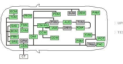

Here's what that screen looks like live - with no codes in any module (they are green) The gray modules do not exist on that car pictured. (that's from a 2015)
