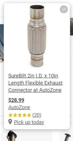

A good muffler shop can replace just the flex pipe - There are many shapes and sizes available
