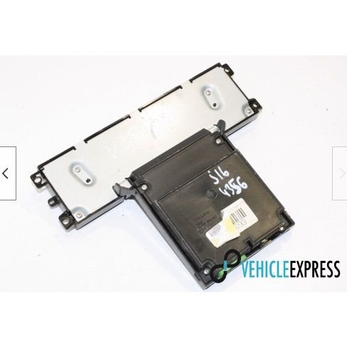

You will find it very expensive to TRY to replace that system to one with more capabilities such as Nav and music streaming. Below is what your ICM (infotainment control module) looks like - you probably won't find an aftermarket unit that will fit in that space. Years ago I used a proclip mount like the one below - mounted a ball on it and attached a garmin nav screen. Centered it over the emergency flasher button to not block the ac flow. Removed it a few years later and it left no marks. Added a 12v outlet behind the water fall (easy to extend the wires from the existing outlet without taking much apart, just drill one hole behind the waterfall) Then the power wire was somewhat hidden and not draped across the interior.
