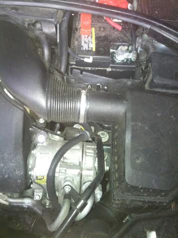

Old Feb 14, 2014 | 08:03 AM
Jotabrow's Avatar
Joined: Feb 2014
Posts: 7
Originally Posted by damien360
that's what i'm not understanding. I'm not entirely sure he knows where the alternator is or the correct year of the vehicle.
Old Feb 14, 2014 | 08:10 AM
ES6T's Avatar
Posts: 5,517
Likes: 73
The silver thing with the two refrigerant lines going to it is the AC compressor.
Old Feb 14, 2014 | 08:11 AM
Jotabrow's Avatar
Joined: Feb 2014
Posts: 7
Ahhh well that's my mistake then!
Old Feb 14, 2014 | 08:15 AM
Jotabrow's Avatar
Joined: Feb 2014
Posts: 7
In that case, would it make sense for the compressor to be whining after the engine is shut off, and for that to somehow be draining the battery to 11 volts? It's just weird that the volts drop until the whining stops (about 2 mins).
Old Feb 14, 2014 | 09:21 AM
ES6T's Avatar
Posts: 5,517
Likes: 73
If the clutch is staying engaged for some reason, yes, it could drain the battery. I've never seen this make a whining noise though.
Looks like you're gonna need a new battery and possibly ground cable too.
