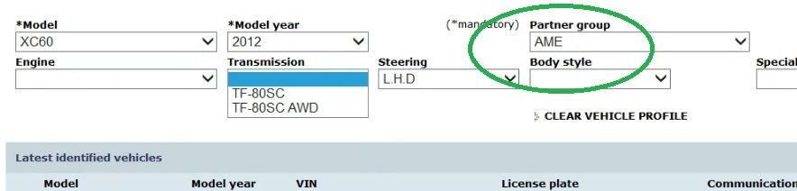

I found this and put in the VIN
https://volvoforums.com/forum/vindecoder.php
It says "Transmission: type 6" and "6-speed Geartronic". Nowhere does it say either MPS6 or TF-80SC.
