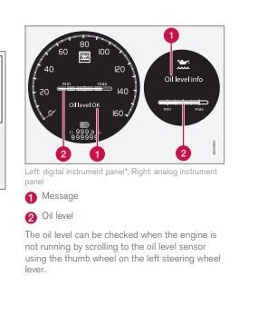

If you have the proper amount of oil in the engine and you get an error - you may have a bad level sending unit. I trust you have checked your oil level and it does not read correctly or read at all, as illustrated below.
