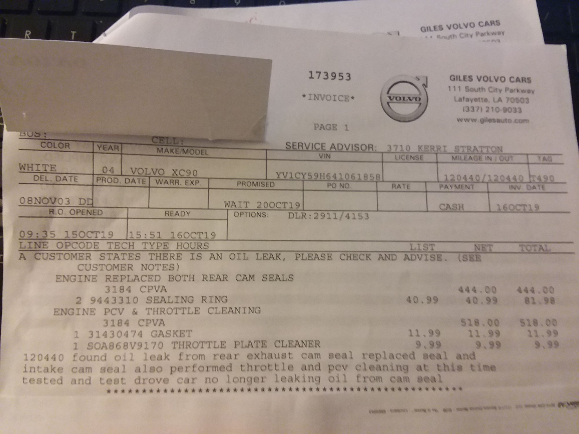

Attached is the invoice for this "PCV cleaning" recommended.
I am concerned this PCV situation may not be fixed. Can you see the video? I did call the service advisor back to inquire about the matter. She said she would speak with the mechanic and call me back. What is your opinion?
Attached is my invoice from this week.

mt6127 or someone who can tell me - attached is the video converted to avi. As discussed in the thread, I was advised to clean the PCV and throttle body this week and I paid for it and I paid for a new oil trap box in 2013 40k miles ago. The leak is apparently fixed. So was the work that I paid for, done?, based on what you see in this video, is this PCV system in good shape or can it throw out another cam seal and cause another leak, or cause other problems?

Can somebody please tell me about the health of my PCV system? I see absolutely no difference.
If the PCV system was really replaced by Bergeron Volvo in 2013, 40k miles ago (and both they and the lafayette mechanic called it an "oil trap box"), then I should not be having PCV problems. Especially after i just paid $600 for a cleaning (that the mechanic recommended and I did ask if the PCV system was ever replaced and I did ask about getting a new one). I see absolutely no difference.
If it is not a PCV issue, but worn pistons, then that would be because of the wrong oil being used in the car, would it not?
Had I realized the PCV system was allegedly replaced, and would come out the same, I could have had Briskers take care of this back in New Orleans and for $1000 more (less travel expenses), I would have also have 2 other new cam seals, a new timing belt, and a new water pump and thermometer. (even though the timing belt does not really need to be changed until 2022).

Given your oil separator (flame trap) was replaced recently (they should last 100K+ miles unless the engine has ring/cylinder damage), I doubt if its gummed up - plus with that hose fix that stopped the glove from inflating suggests the PCV system is now functional based on your observation that the rubber glove on the fill cap is no longer inflating. The tech should be seeing a similarly acceptable reading on their pressure guage.
As far as doing cleaning, it should be a recommendation after doing an inspection not as a "we see this all the time" since you have had some prior work donel As to black market for parts - that's not really what dealers do. Dealers are able to source parts directly from Volvo - ie those parts carry a "Genuine Volvo" brand and are warranteed by the dealer should the part fail prematurely. Some dealers will also source after market parts to save money for the customer particularly for older cars but you don't get the same quality guarantee. I've also had my dealer allow me to provide parts (with no guarantee on the work should that part fail) so the key is they should tell you in advance when they are NOT planning to use Genuine Volvo parts or give you a choice.
