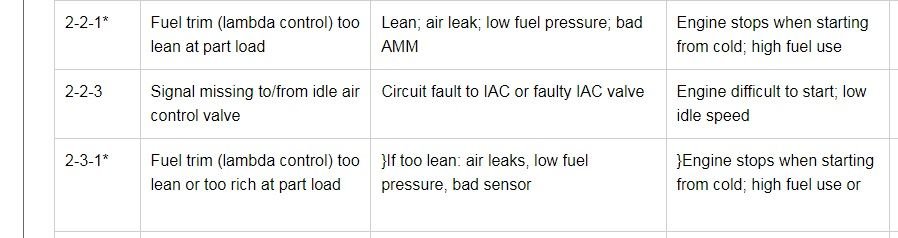

I got 221 on the flashing light diagnostic tool, which as I read on Trouble Codes means “Heated Oxygen Sensor(Rich mixture/part throttle).” and also 231 which means “Lambdfa adjustment”.
would the oxygen sensor be what’s at fault here then?
Old May 31, 2022 | 05:44 PM
Have you erased the codes and driven the car to find out IF any codes come back? If not that would be the first step. Those are fuel trim codes with many possibilities and usually hard to solve because they can take a while to return (without just throwing parts at the car) The codes mean the control unit does not like the signals it's getting not that the part you are imagining is bad.
Old May 31, 2022 | 09:58 PM
Likes: 540
+1. O2 sensors always get cited as a possible cause for lean conditions when its just as likely that your 33 year old rubber bits are hard and crusty. Things like the rubber o-rings around the injectors, vacuum lines, intake air boots etc should all be inspected - you can spray some carb cleaner to see if any gets sucked in and bumps the idle etc or have a shop do a smoke test just to be sure. Also you can clean the throttle body and the idle air valve to make sure its not leaking air. Any other driveability issues??
