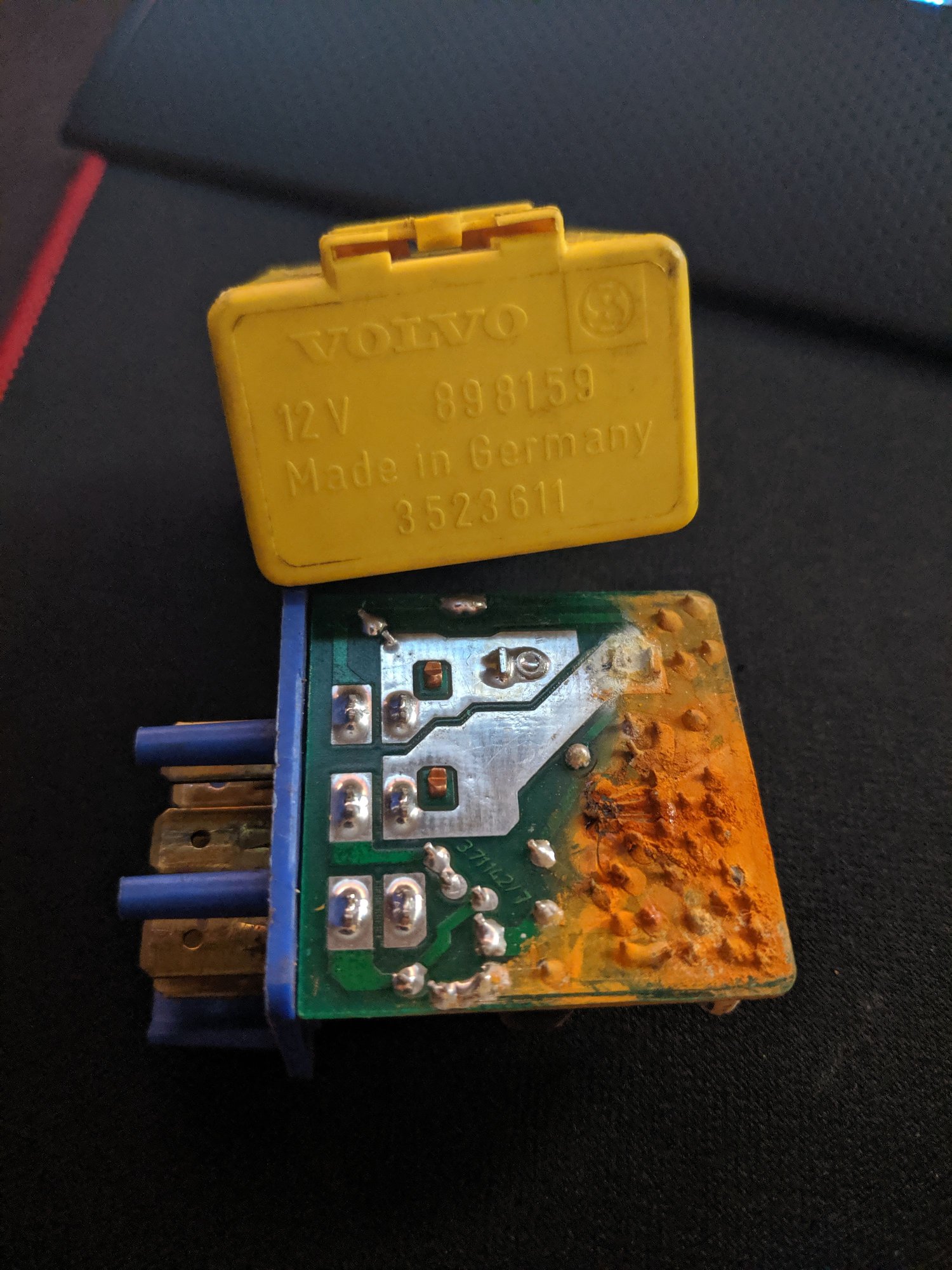

Title pretty much says it all. My new to me '85 wagon's rear wiper stays on 100% of the time regardless of the position of the switch. Right now I just have the fuse pulled to stop if from running, but i'm starting to miss my radio and clock which are fused on the same fuse, so its time to fix it haha. Any ideas on where to start? Maybe a relay, wiper switch, bad wiring, the motor itself...?

I ended doing some trouble shooting and the relay was completely shot. I replaced it with the front wiper relay and the rear functioned normally. Both relays were located under the driver's side dead footrest pedal fwiw.
