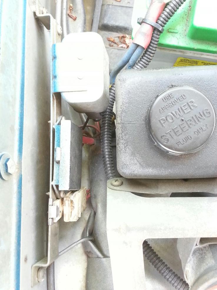

Thanks all for the guidance. Spark checked out fine. There was no fuel coming from the pump to the rail. I called my local Volvo expert and with this info he said I would need to clean or replace the 25amp fuse in under the hood next to the battery (3rd unit). Sure enough this got the pump working and the engine fired right up. I saw no obvious mention of this in the Haynes manual. What a simple fix! But I live on the north coast of California and corrosion was likely the culprit.
Wait a minute! I have a 1993 240 wagon and all the manuals point to a "25 Amp Fuse" in that location. However, after looking at these pictures I realize that I don't have a fuse there! At least not a regular fuse that looks like a fuse. All I have is that black box just in the front (just above in these pictures) of that fuse.
Does anyone know what's up with that? With all the complaining people have done about how weird this 25 Amp fuse is, I had just assumed that all the connectors in this black box were some contrived form of fuse.
Old Jun 4, 2013 | 10:57 PM
thats exactly it, at least on the later LH cars. ok, this guy has a 90 (there's someone with similar problems on here with a 83, these early versions are a little different than described below).
the 25A fuse under the hood of a 240 (or fuse 1 on a 7/9) powers the entire fuel system. the 'fuel pump relay' on most(*) of the later cars is actually a dual relay, one half powers the ECU and injectors and stuff (ok, on a 7/9, the injectors are on a separate socalled "radio suppression" relay), the other half the relay powers both fuel pumps. the in-tank pump is on an additional fuse (fuse 6 on 240s, fuse 11 on the 7/9's), but ALL of the above is on that main fuse.
