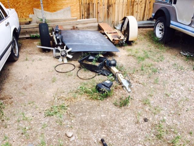

I set the cams in time. It started and ran perfectly, no odd sounds, smooth idle, raised to 3k rpm sounded good . I shut it off quickly as the water pump pulley was off. Must be that the cams can be off quite a bit before damage occurs. Pieces of plastic must have fallen between the belt and the crank sprocket causing the belt to slip a few notches. I have the grille, the hood, and the headlights from the local sell serve wrecking yard. They have only one 1990 740. To be safe I am going to get a new timing belt and balance shaft belt. I found loosening the tensioner was easy with large channel lock pliers. I had to hold the passenger side cam sprocket in place as it wanted to move off of its mark.
