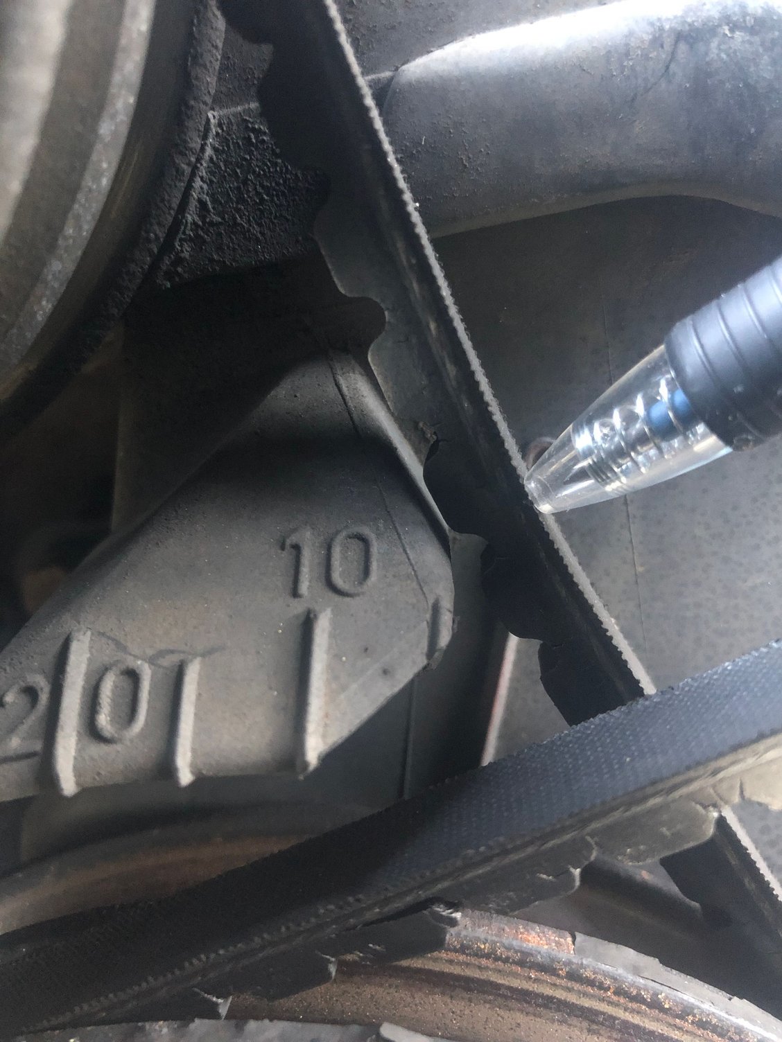

I heard a concerning ticking coming from the engine bay of my ‘91 945 Turbo and upon further investigation I believe my accessory/serpentine belt is very loose and is tapping against what I believe to be a plastic guide. I recently changed my alternator but I kinda doubt that’s related? I don’t see any of the usual bolt-style adjusters or any tensioners from above or below, I must be missing something. I’ve tried looking around online but can only really find info on alternator belt tightening. Any help appreciated!
Cheers!
Pushing down on the belt with a pen, I realise that it’s not touching in this photo but the belt is plenty loose to touch it.

You need to change these belts asap! They are falling apart, chunks coming off! They all have adjustments and are not hard to do, and yes they are very loose, and they are not "serpentine", just belts. https://www.matthewsvolvosite.com/fo...ic.php?t=34812
