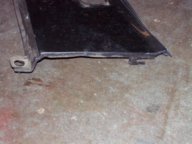

You are correct, the motor is located under the cowl but don't despair...it is child's play to access. Remove the wipers and three bolts and is off the car. These pics are of a 91 740 cowl and wiper mechanism so it's exactly what you will find. The engine bay shots are of a 90 model which also attaches exactly the same.
The cowl attachment points...

The cowl has forks on the side edges that hook to hold the rear and sides down. After removing the three bolts, pull forward and slightly up...

And, yes, I'd check the switch first. But, as you can see, removing the cowl is really not tough...If you find your motor is bad, it's simpler to swap out the entire assembly...the one in the pics is available should you need one.
