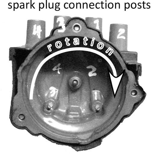

it ran before you did this work? are you sure you hooked the side wires on the coil up in the correct order? power wire (probably blue) goes to pin 15 or (+), ignition timing signal and tachometer wires (probably white w/ red stripes) goes to pin 1 or (-) ?
sure you got the spark plug wires on the cap in the right ignition order? timing order is 1-3-4-2, where the frontmost cylinder is #1, and the rearmost is #4 ...
on the 940 cap, things are numbered like this (as seen from the inside of the cap)
those caps mount with the plug wires pointing to the right side, so top to bottom, its 2-1-3-4
