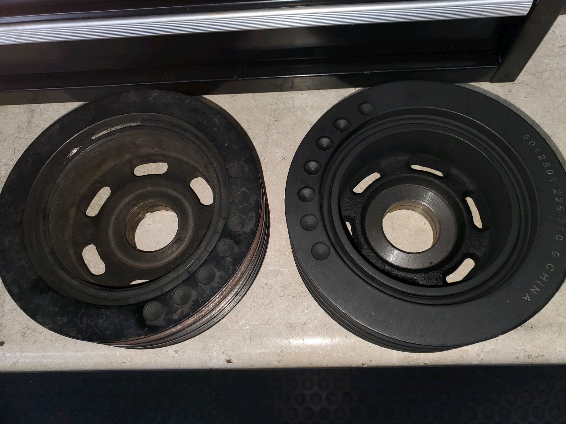

Turned out to be coincidental, my harmonic balancer i found to spin freely! And the crankshaft keys are sheared! Awesome. There is also lots of belt wear on a brand new tensioner and the new timing belt has heat cracks. Does this mean its done?

Just replace the belt, it's cheap. Why the heat cracks though?

i replaced my harmonic balancer a couple of weeks ago. It’s a wearable part Your VOLVO is fine.
remove #1 spark plug. Pack cylinder with rope to stop progressing to crack nut. Replace belts
