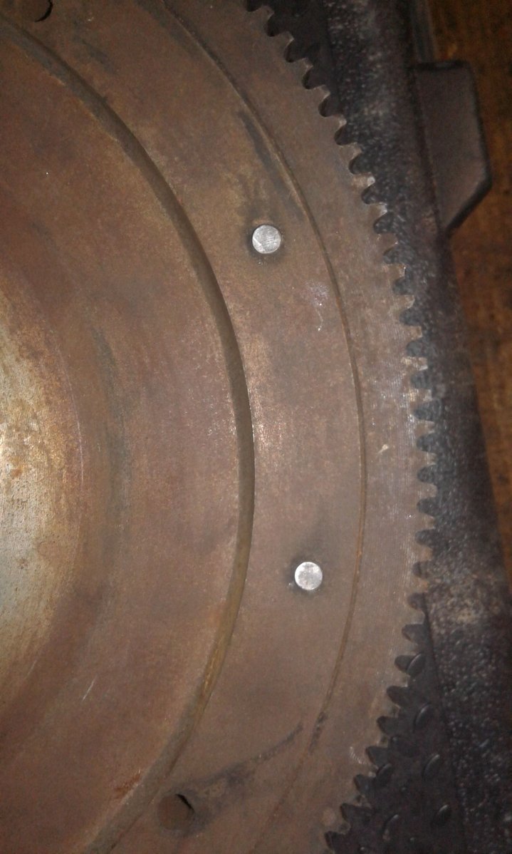

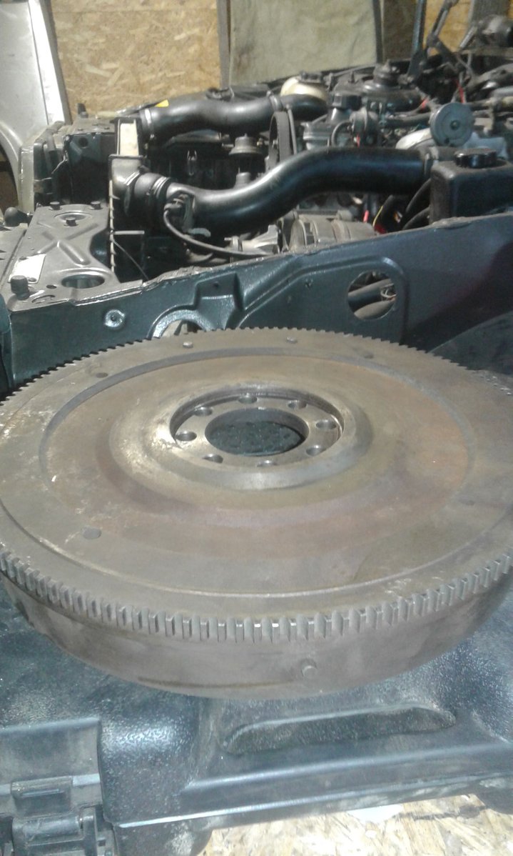

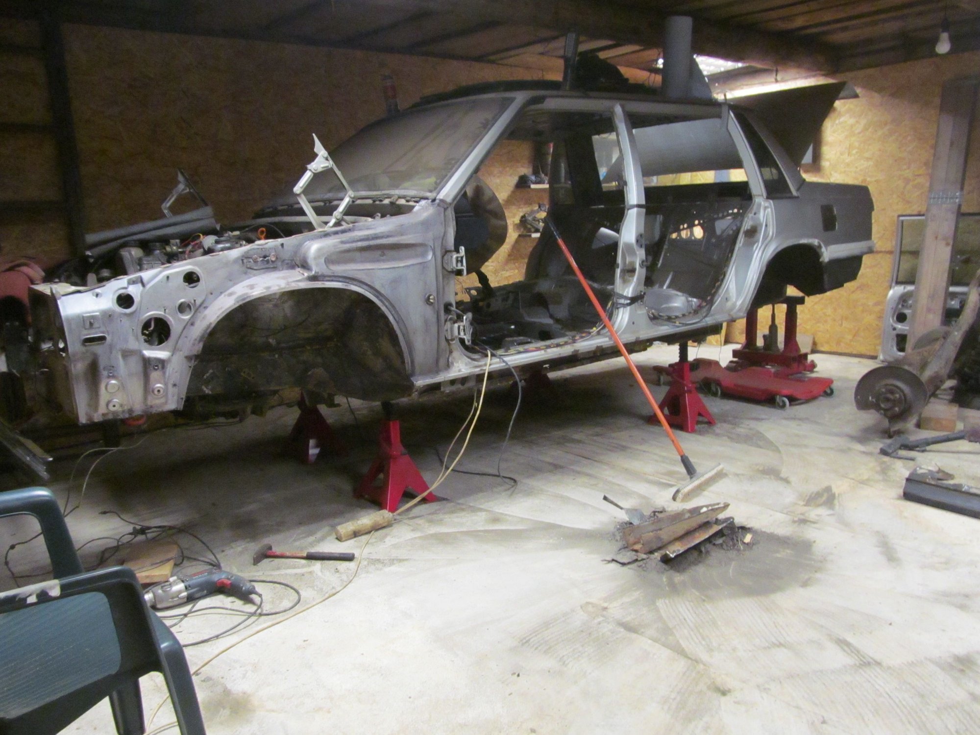

I am ViesiS from Latvia and i am a bit of a volvo fan. I own xc70 2.4 turbo from 1999, 240 2.3 carburetor from 1989, 1996 volvo 850 2.4 10 valve, and my favourite 740 2.3 turbo. I own a 1985 Volvo with 2.3 turbo/intercooler B230ET Bosch Motronic engine in it. This car is special to me, because i own it for 8 years now and i bought it with my first paycheck after university, but sadly i droved only two years with it and then i had to put it away in a garage to fix it. But my fixing ended up with a complete rebuild of chasis, and ours of ours of welding, and now, after 6 years of fixing it i am allmoust done. But by putting in an engine i stept on a hughe problem. I have some rare flywheel with only one pin on its side and i did not mark any position of it, before takeing it of and i cant finde any information of how to set it right, and i hope someone could help me here, because i am desperate right now for a few months with this problem and dont know what to do. There is a picture with flywheel, so a
This is my flywheel with only one pin on it side. Volvo is 2.3 B230ET Bosch Motronic.
ny ideas?

You are trying to set it to the sensor? Is there an arrow on the flywheel so you can align it with the sensor?

I have Bosch Motronic, it is on a passenger side and there is an original volvo sticker in the engine bay that says, that this volvo has Bosch Motronic, and there are no hall sensor in distributor, I have 2 sensors by the flywheel. And there are no timing marks on flywheel, just that small pin. Car was runing prety good before i tooked engine out and replaced crankshaft seals and put it back in, but now, no start, just coughs in to the air intake. I have a good spark, good fuel pressure, and all timing marks on timing belt are correct, only problem is my flywheel.

I was trying this:
1. Set up cranckshaft on a TDC
2. Then turn engine back 90 degrees before TDC
3. Then put the flywheel back on so the pin is right on the sensor
4. But still no go......it fired up on 2 or 1 cilinders and thats it.
Maybe i have mixed up spark plug wires....!!!
And maybe someone can tell the right firing order on this, because i finde so many information in internet about firing order on these volvos, i am a bit confused.
Maybe i am missing somesthing.

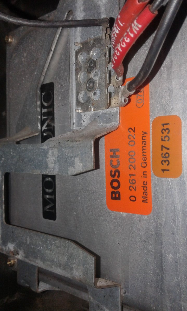

Sorry about mistake, sticker in an engine bay says B230ET, but in the car.........
there is a Bosch Motronic in passenger side

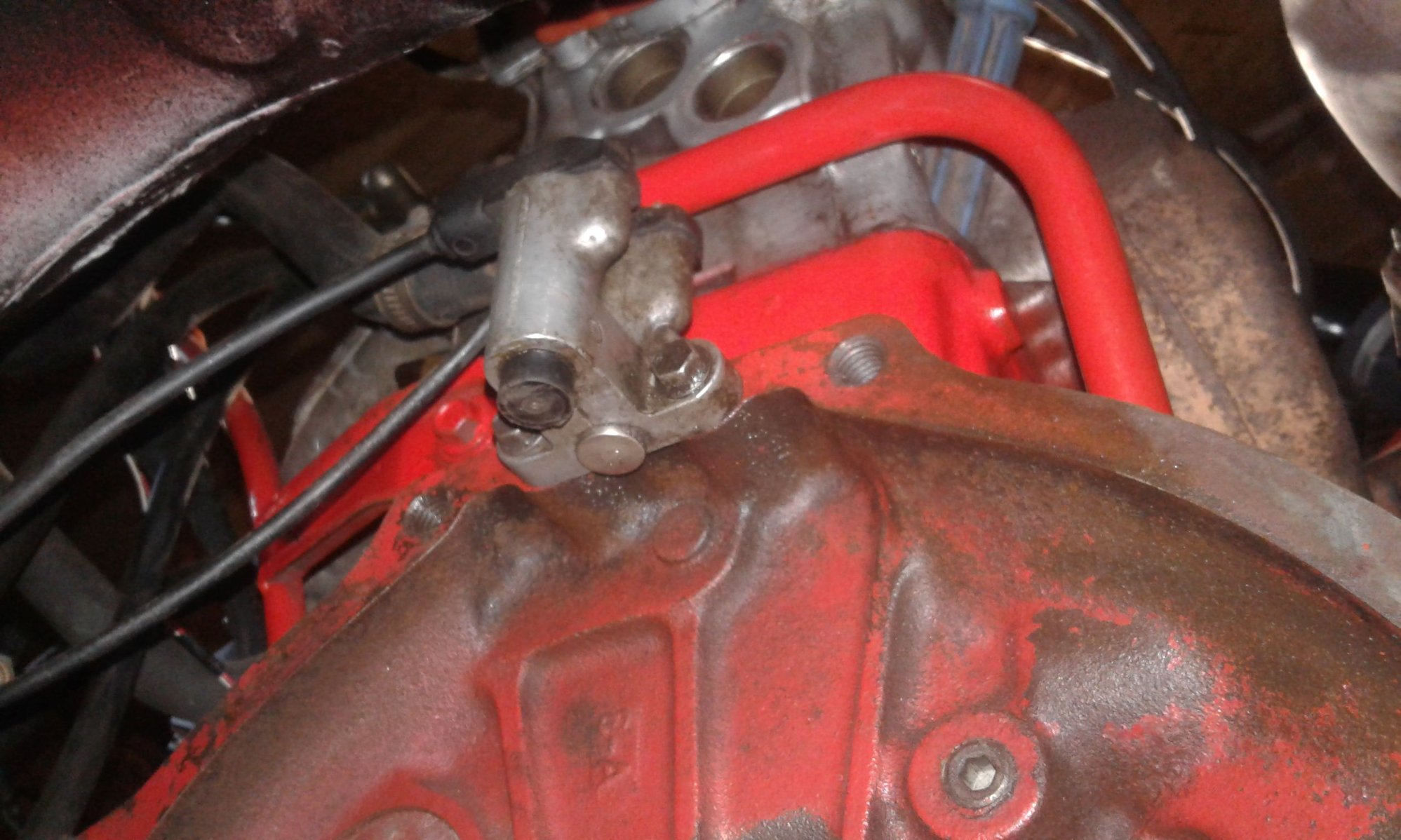

Two sensors........

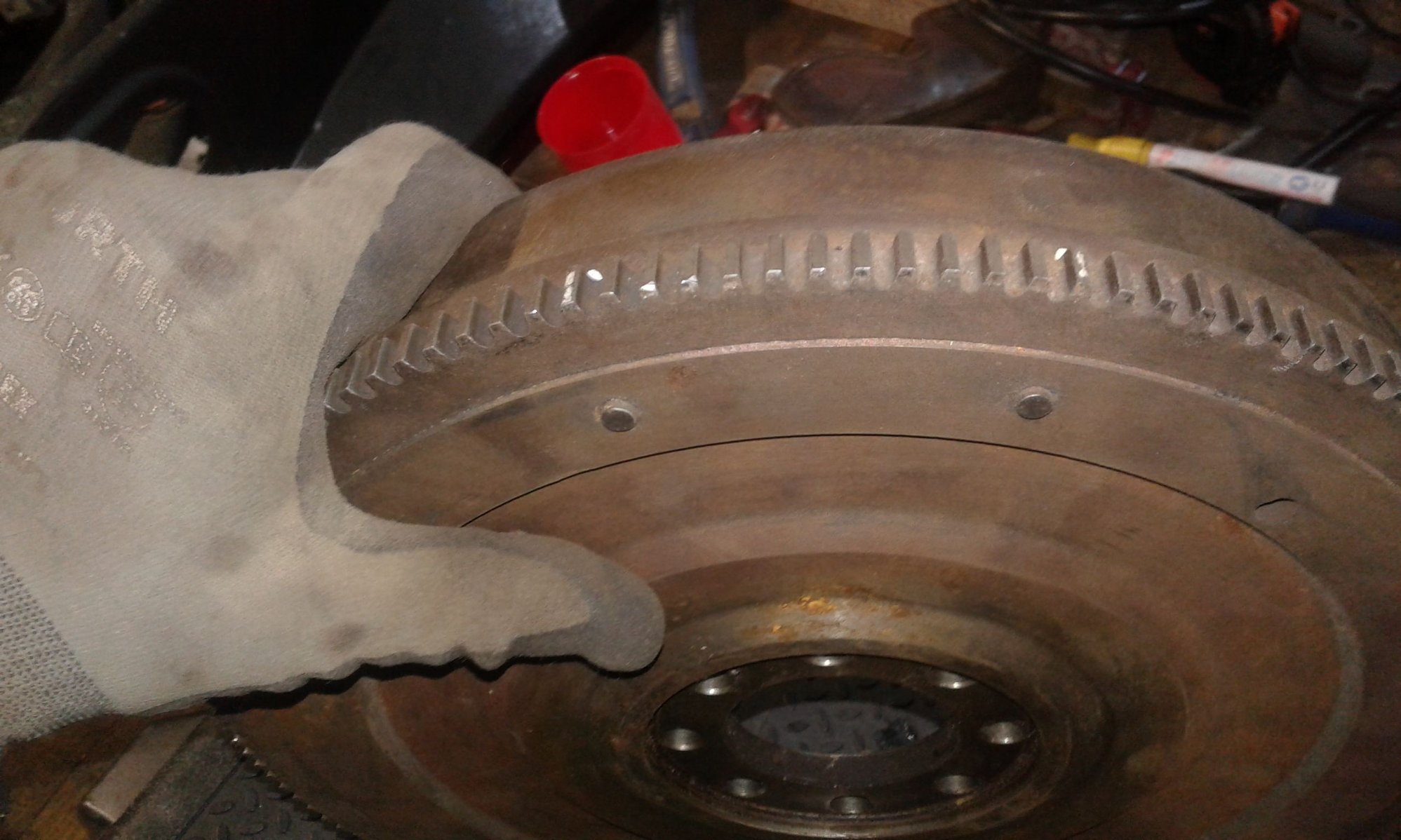

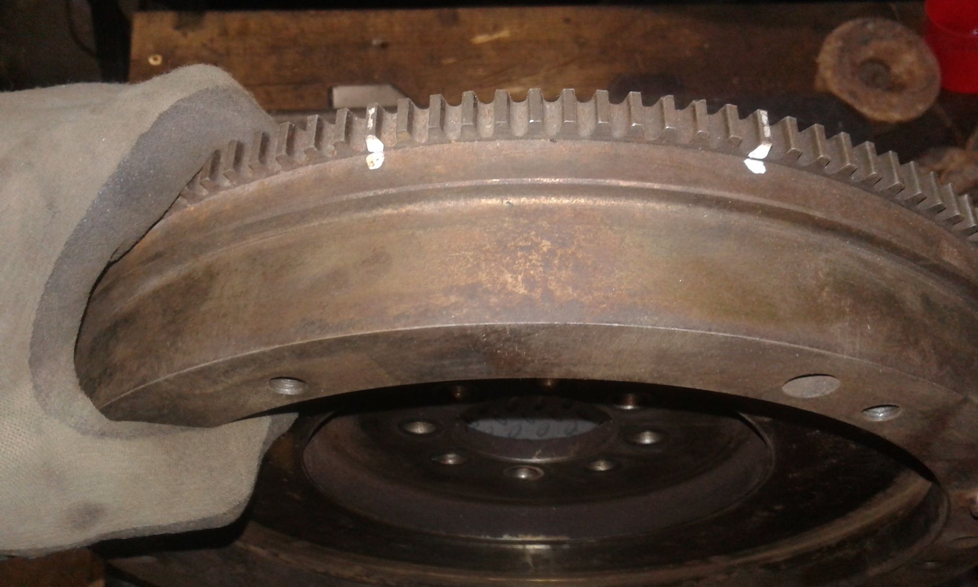

Flywheel off......and that pin for sensor is opposite from those two small pins on flywheels engine side
Engine side, two small pins, did not see them before.........
And someone before me has made some marks with white "pen" on flywheel, but i dont know if i want to trust them......
better view
from gearbox side

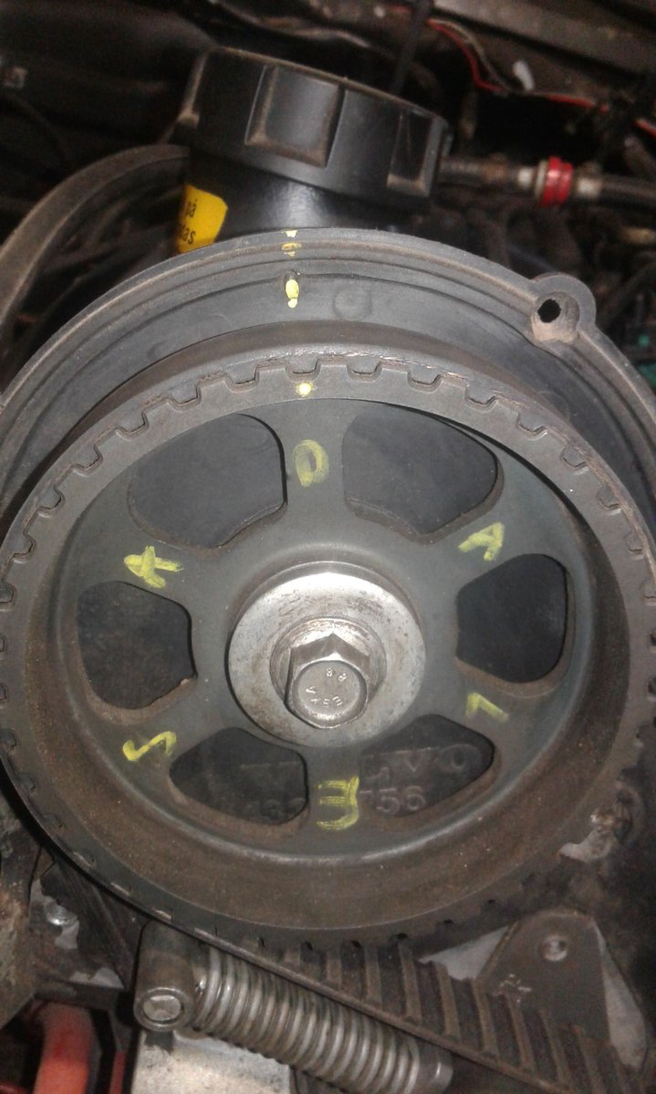

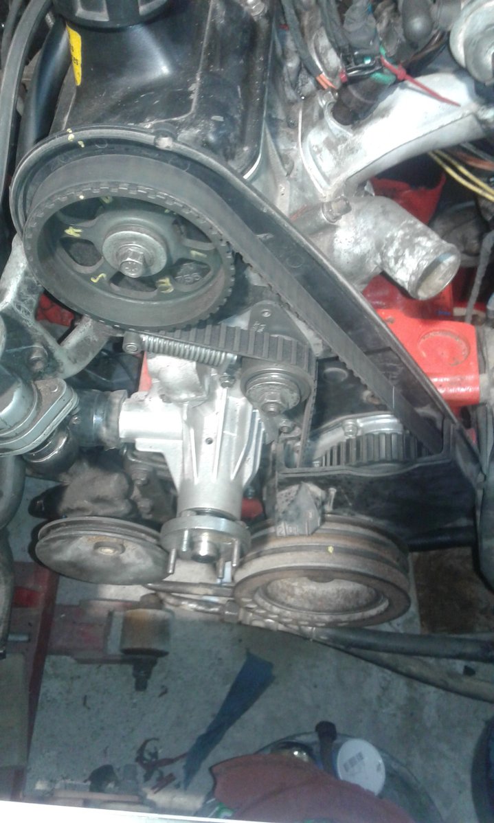

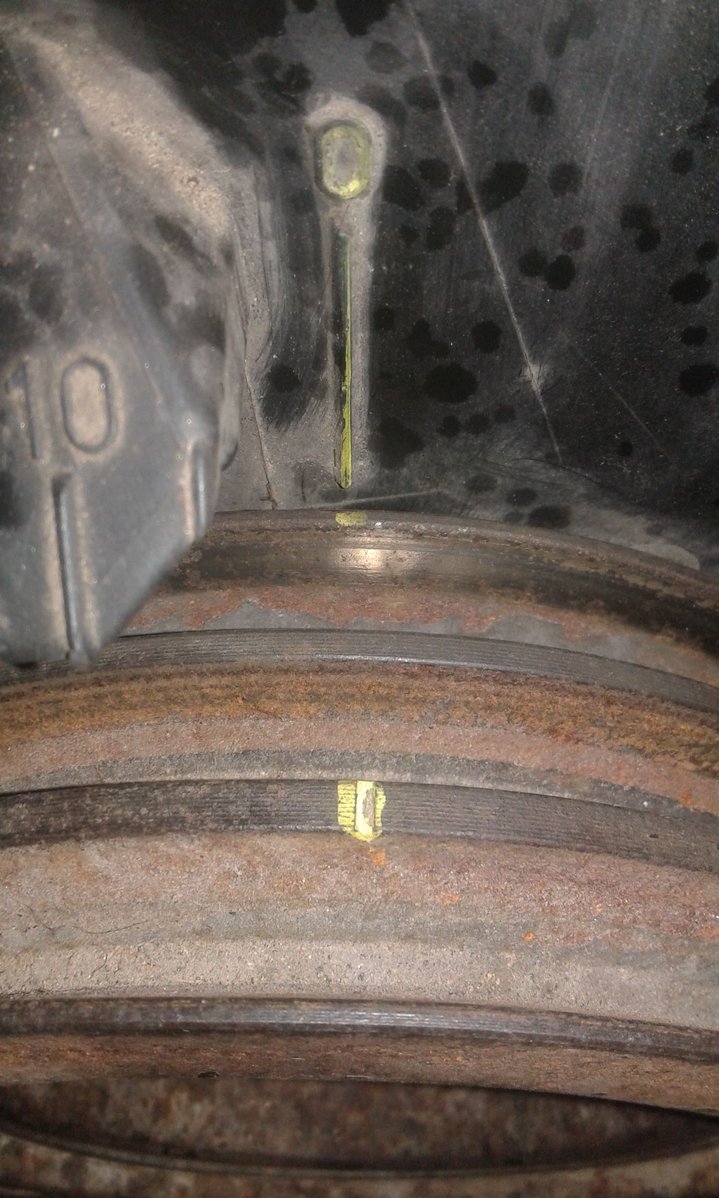

marks on a tming belt
looks good to me
lines up pretty good

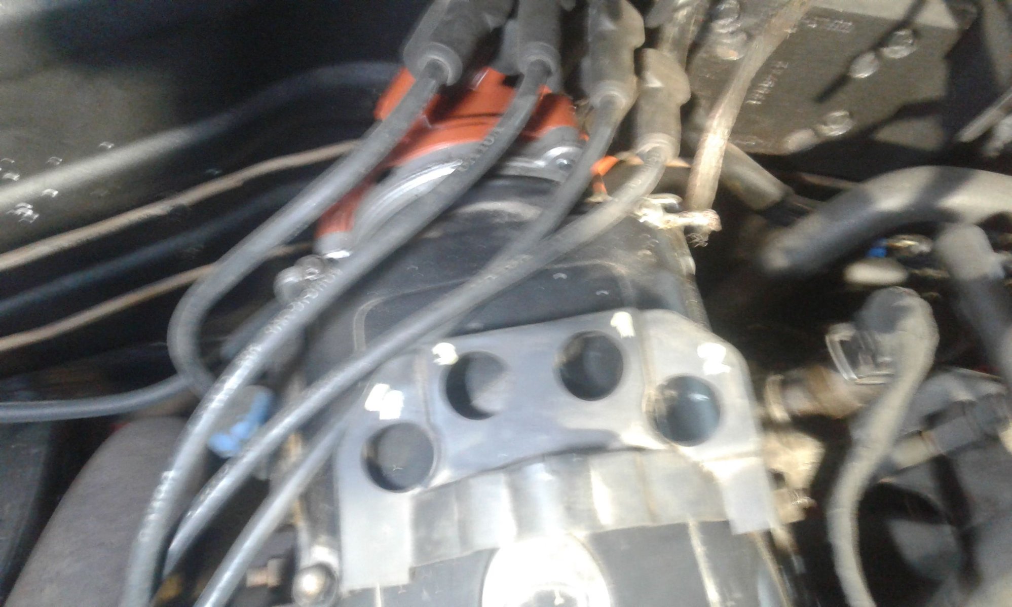

this is how i placed my spark plug wires
Any ideas how i should play this......

Your wires are correct, the following should help:

But this is for automatic gearbox and there are holes in that plate, i have no holes only one pin on flywheel side and 2 small pins on the engine side of the flywheel.
But, if i put engine on a TDC, where should that one pin piont at??
