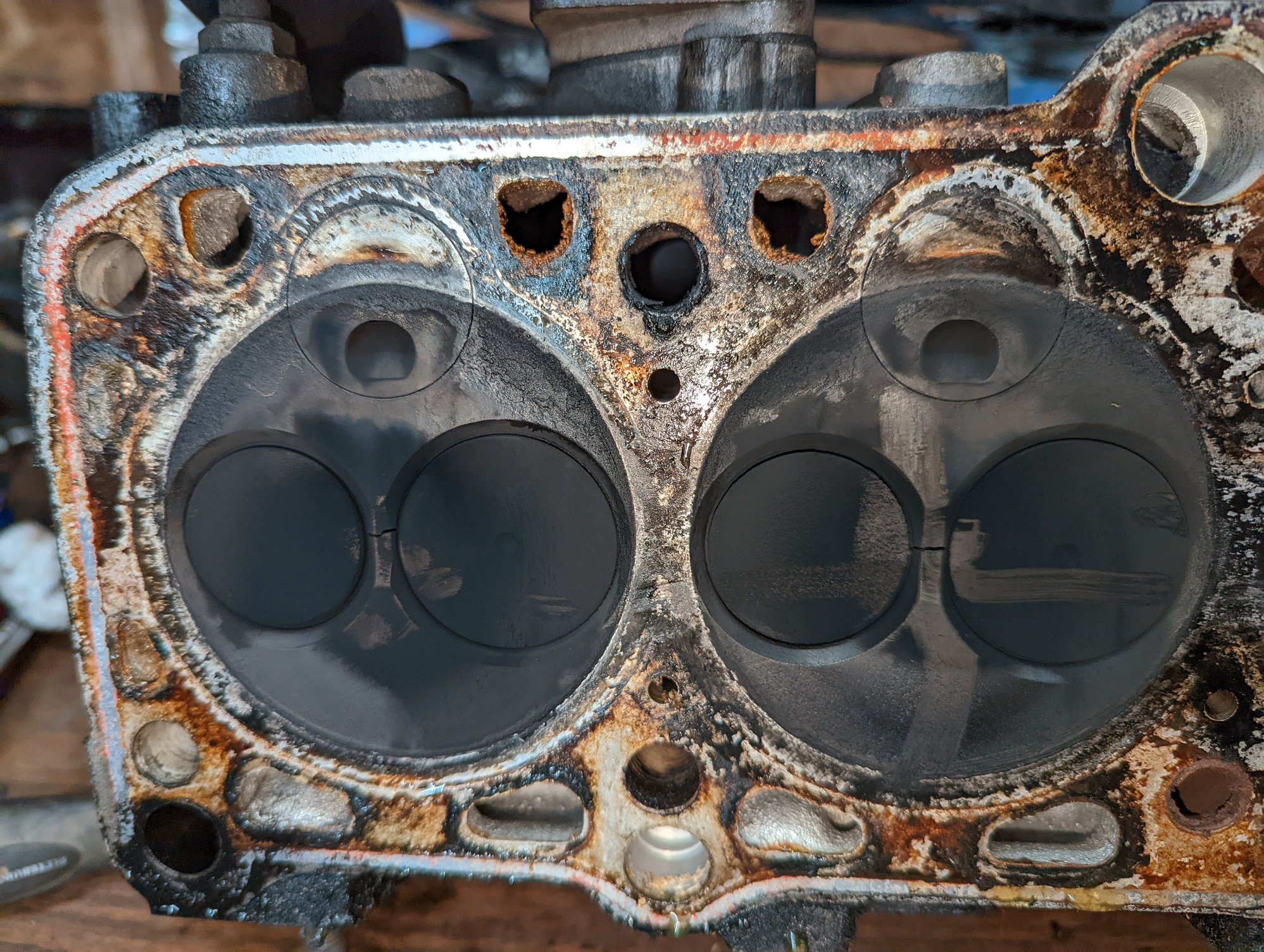

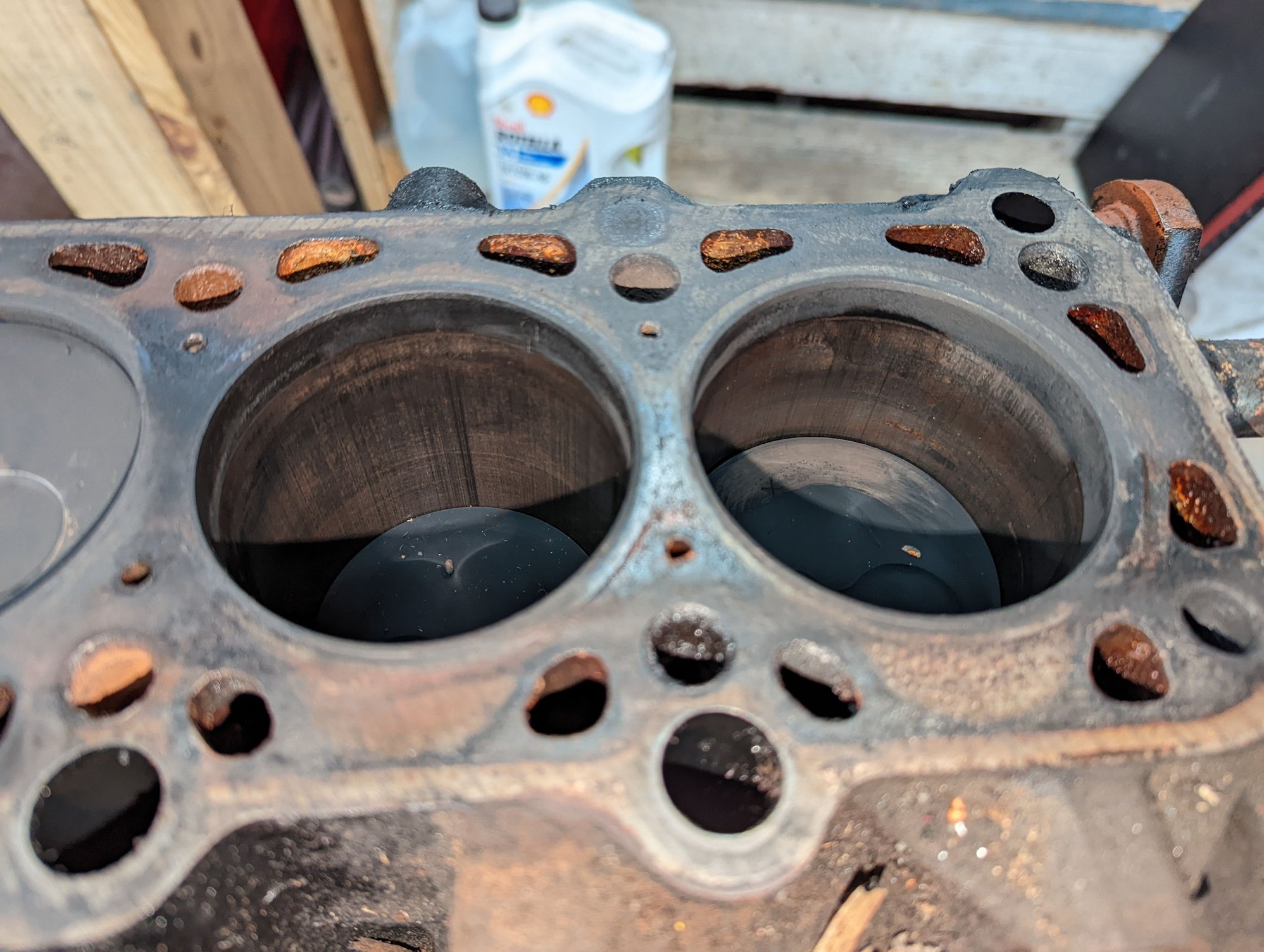

The cracks between the valves (that's normal if you're unfamiliar) are a little wider than I'd like to see, and quite a bit of the #6 piston was in the oil pan, but it wasn't grenaded or warped. Just tired.
It can definitely be brought back to some degree of serviceability, but my friend somehow managed to find a "freshly rebuilt" d24t longblock a few years ago, so it's going in the car after freshening up the equally abused ZF22.
I have no Idea where it came from or who assembled it, so I'm going to take it all apart to check clearances and ring gaps and whatnot, But I want to get the interior apart and get a better look at the rust situation first.

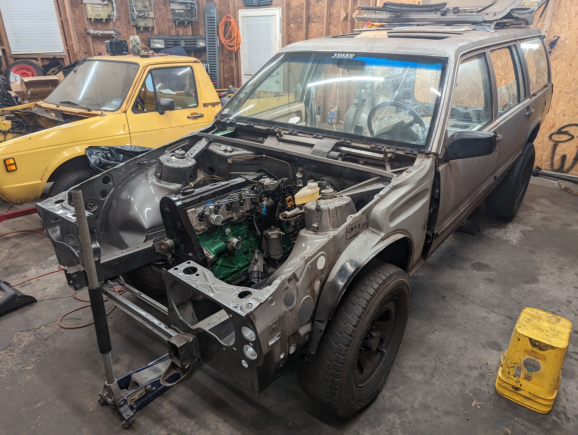

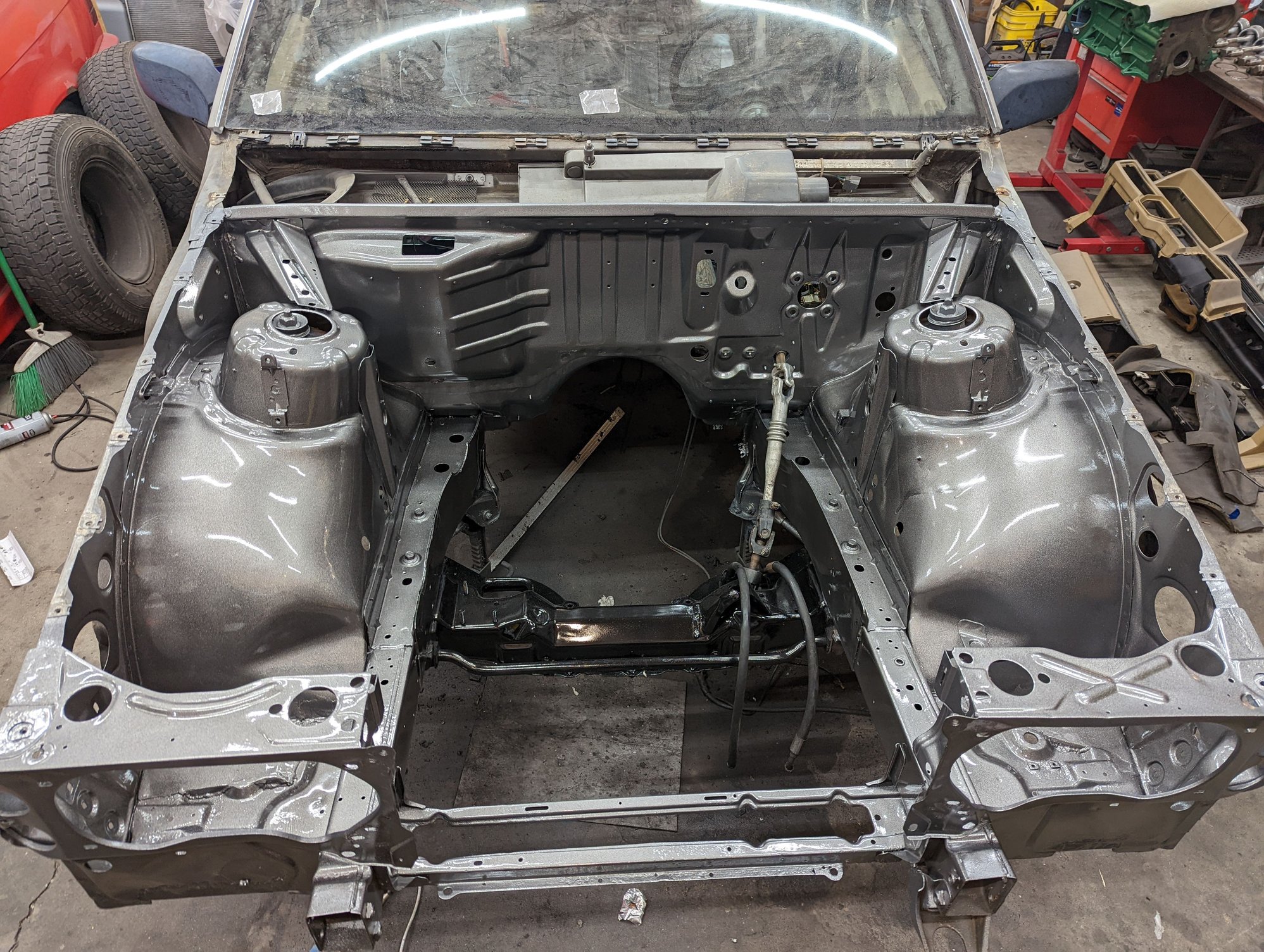

The pretty engine was just as pretty on the inside, the head is freshly rebuilt, the bottom end is all brand new and it's even .5mm over bored. Currently waiting on the head gasket to put it back together.
She had the expected Pennsylvania spicy sadness.
I had enough extra Chevy hood to fix all that mess.
I got the bay painted too, I'm using the cheapo acrylic urethane "carbon fiber metallic" from Summit. It's a very close match for the original color. I somehow managed to cut the air off to my gun mid-pass and dripped paint all down the captain's side strut tower, hence the runs. could be worse. I'll make it "better"
Dash and HVAC box are also out for new heat exchangers, blending door seals and some electrical tidying.

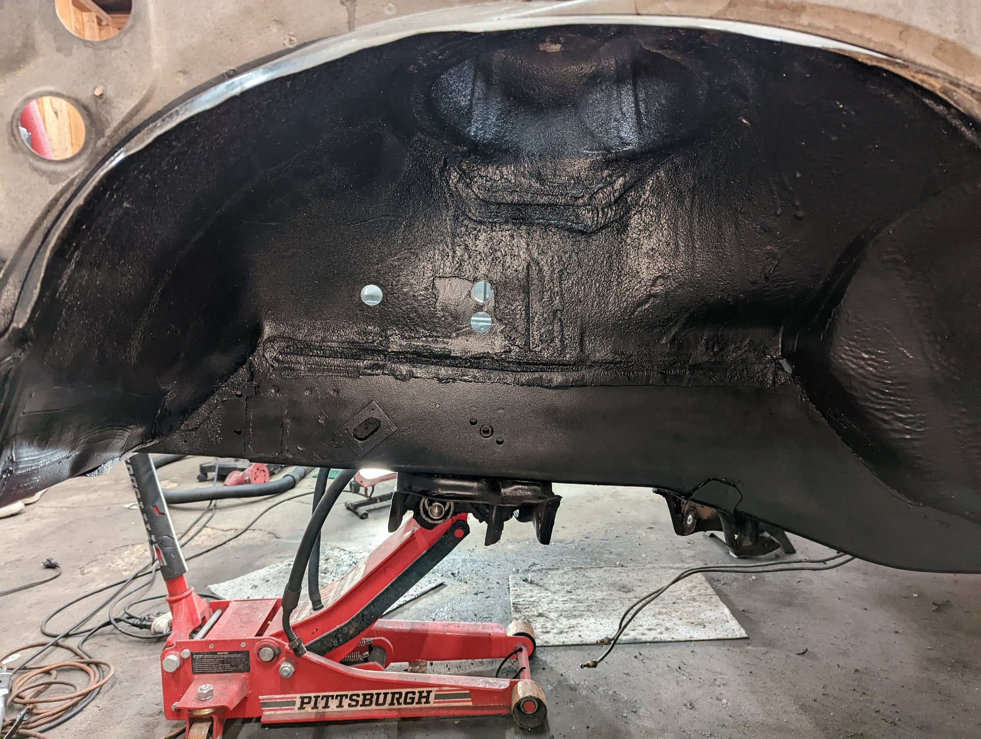

Currently working on the rear suspension; decided to just drop the axle out to address the rest of the road tar undercoating.
Not sure if its original to the car, but we got a centrifugal LSD.

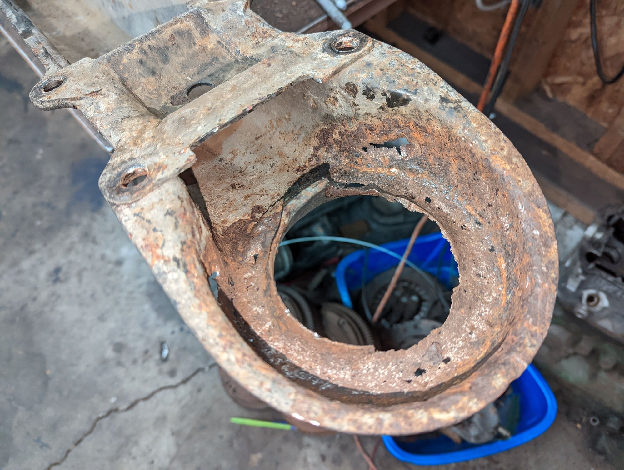

The trailing arms were completely rotten around the spring seats. I wanted to rework them anyways so have a spring mount a little sturdier than a hose clamp. It is lifted using WJ cherokee springs and Durango shocks.
Nothing was leaking out of the axle, so I just put some lipstick on it.

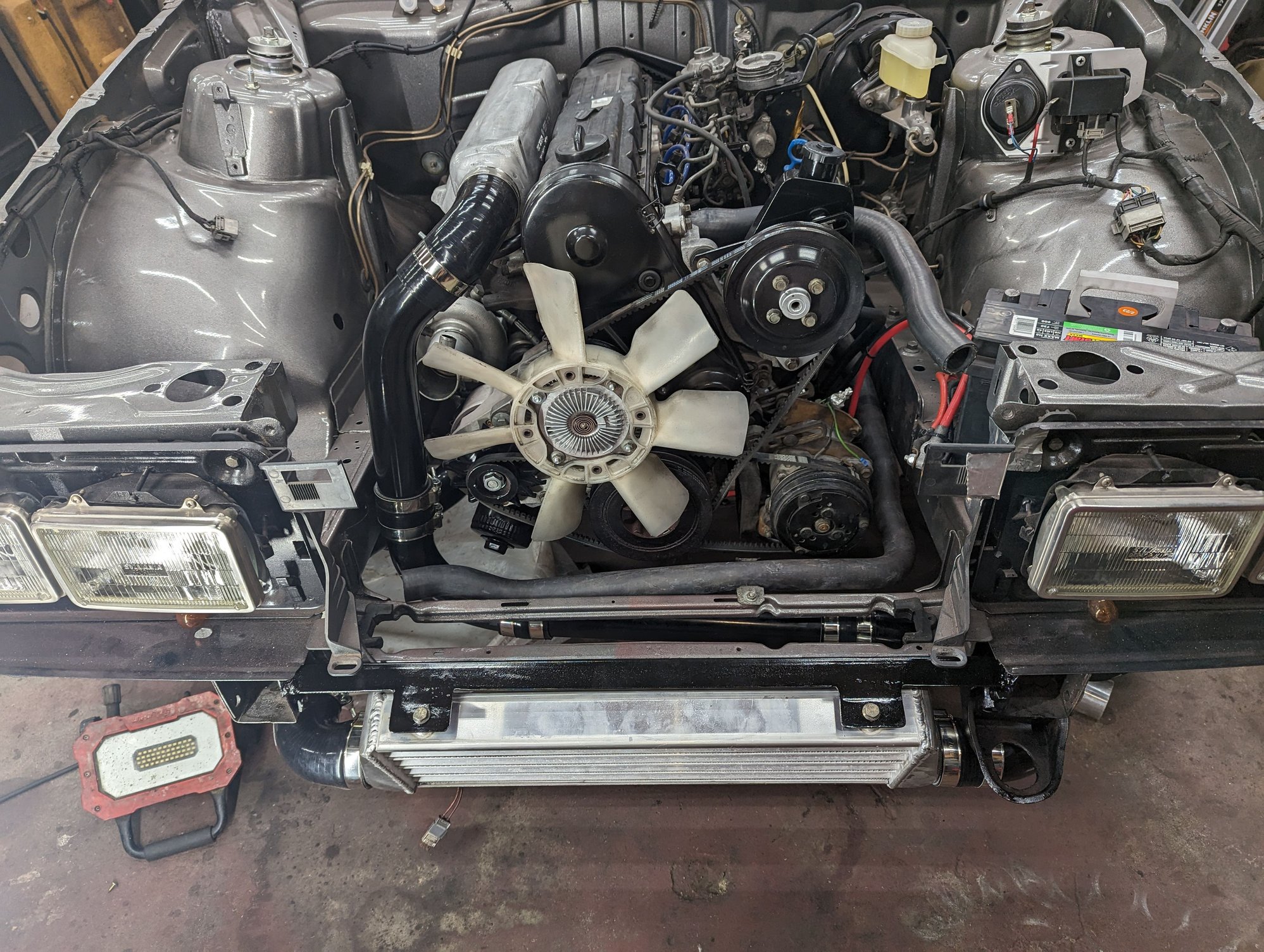

Engine rebuilt with new 155 bar injectors, oversize pistons and 1.4mm MLS head gasket. The rest is stock.

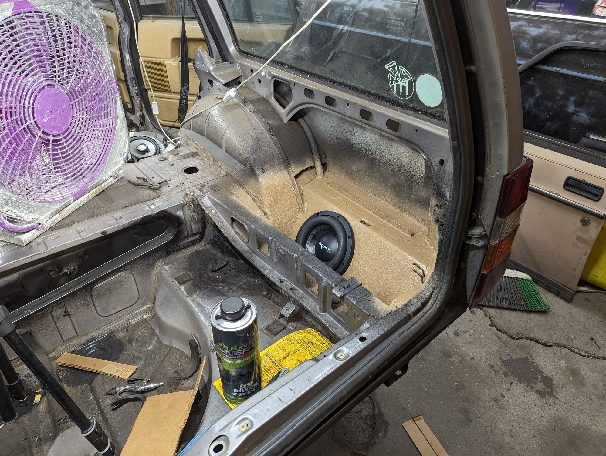

hidden 8" sub, amp hidden in the cubby on the other side.
New turbo cartridge and intercooler setup.
Made it shiny, Jeep Grand Cherokee Limited wheels, refinished with color-matched windows and 31" BFG KO2s.
New rad and custom trans cooler. Original condenser because it didn't leak.
Turbo Redblock air box mocked up, made some copper coolant lines.
