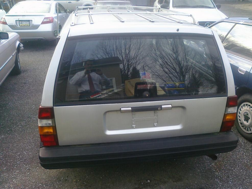

I'm hoping everything checks out tomorrow. I don't know if you saw the pictures, but it looks like the wagon/rear door was replaced. I'll have to look into that. Very interesting about the OD as well, I had no idea about that. thanks for the heads up.
