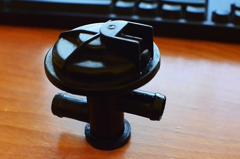

Question 88' 740, What is this part called?
Had a coolant leak, found the part causing the problem. But I can not seem to find what this part is exactly, which is making it hard to find a replacement.

Old Jan 24, 2013 | 08:32 AM
lev's Avatar
lev
Posts: 4,540
Likes: 137
This is a Heater Control Valve. This one is of the all plastic, after market replacement variety. Many cars use it, around $15...

Old Jan 25, 2013 | 02:42 AM
this is the proper part for pretty much all 700/900's
Heater Control Valve - 700/900 Models
or
http://www.fcpeuro.com/products/volv...40-960-s90-v90

Ok, one last question. Do I actually need this part? My car does not have any air conditioning or heater components in it anymore, so can I get away by just putting a short piece of tubing in place of the control valve?
Old Jan 26, 2013 | 04:29 AM
you have no heater?
then you should connect the heater hoses together and not run them through the heater core, so the heater out port from the engine is connected to the heater in line. or cap off both ports, but you have to use somethign that can withstand coolant pressure of 10psi or so.
Ok, I think I will just connect them together. Thanks!
