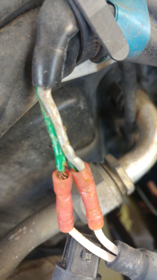

Ok. Had the day off and tackled this issue. When inspecting the pressure sensor harness I noticed it had old electrical tape wrapped around it. I removed it and found this mess. The green wire is split in two inside the butt connector. I rewired it with heat shrink connectors and everything is now beautiful. A/C now works everytime its turned on. Thanks to all the great advice. You guys are the best.
