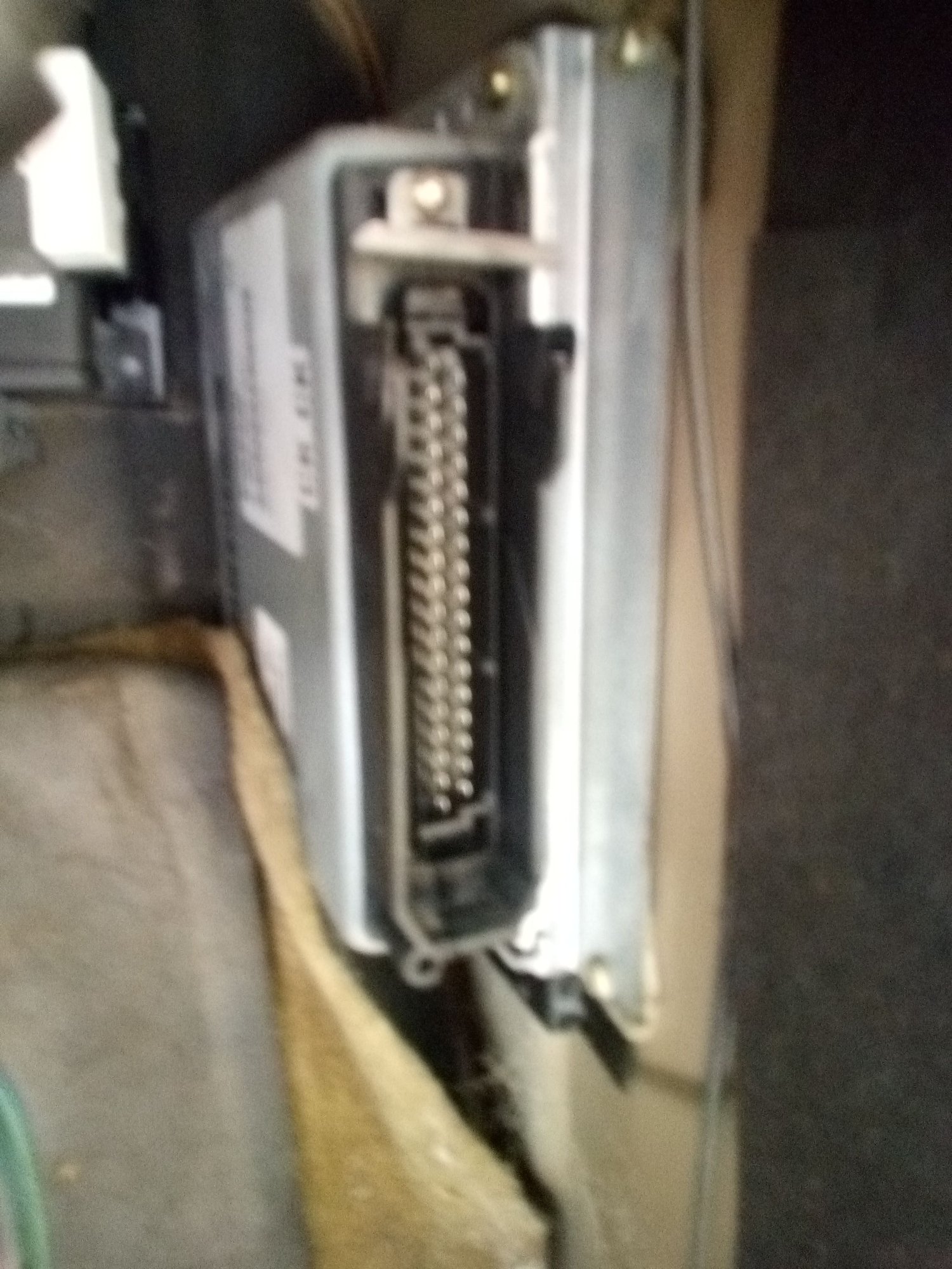

Old Aug 9, 2019 | 10:20 AM
TV540's Avatar
Joined: Aug 2019
Here are the pics I promised... The opaque plastic is all that's unplugged from ECU. Do I test the back of it, or the ECU itself? I'm assuming the ECU, as the other piece doesn't really actually have "pins" coming out of the back. They're more like recepticles.
Old Aug 9, 2019 | 11:14 AM
the plug in your 2nd pic, you have to take the yellow shell off it so you can probe the wires on the back of it while it is plugged into the ECU, that way you can take measurements of the live system.
Old Aug 9, 2019 | 11:24 AM
TV540's Avatar
Joined: Aug 2019
Fantastic! Based on what I see around here, you seem to be the man, Pierce. Much appreciated!
