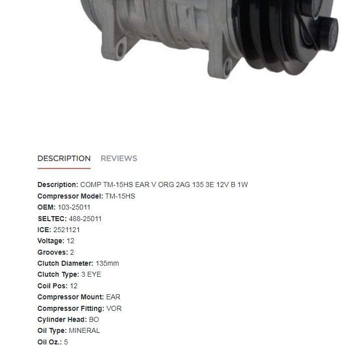

I got mine from ACKits.com in AZ (Be aware, I have a '93 940, so a slightly different animal). Great guys over there. Tim is extremely helpful. They also have an A/C-only forum that's a huge wealth of information. Installed it 6 years ago - still working great. They have everything you need there from parts to tools. With hoses on these, you might have to hit up a custom hose builder for those, since they're starting to get very difficult to source. I ended up reusing my high side hose from the compressor to condenser for this reason, and it took me 5 years to finally source a NOS aluminum line from the condenser to the orifice tube. The design is MUCH better on the '95 940 that eliminates the steel piece under the condenser that rots away to nothing, and breaks upon removal.

The Compressor they have listed for a 92 240 has mineral oil in it. A R12 compressor uses mineral oil and that oil is not compatible with r134. Mineral oil does not mix with 134 and does not lubricate the compressor - then it seizes up. You need a compressor with something compatible for 134 like Pag oil. That site shows the same compressor for a 93 240, that has different threads as is 134 from Volvo - so perhaps it's just a catalog error.

Yep, you're right ... so you flush the oil out with PAG or Ester. Simple. Should flush a new compressor with whatever oil you're using anyway if you expect it to last. You should see the crap that comes out of new compressors. Scary! That's why warranty claims are so high on the ones sold from Advance Auto or AutoZone, and a few others.
I always dump the flush oil into paper towels - they'll have black spots all over them after the first few flushes. Dump it in, twist the clutch over several times, dump out, repeat. So simple a child could do it.

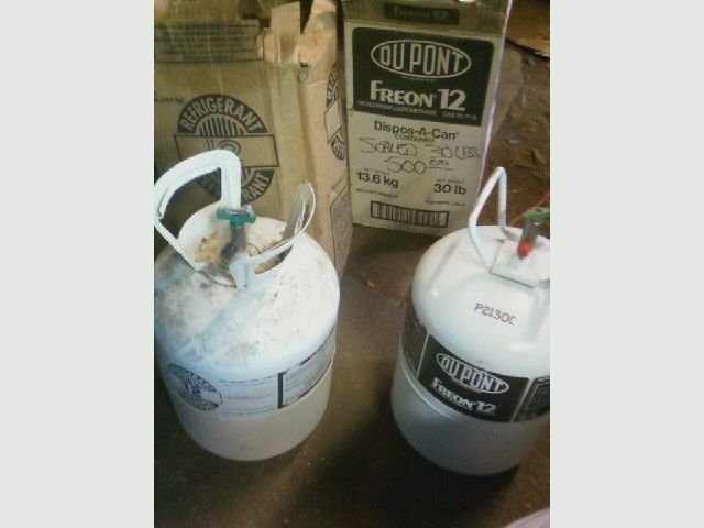

Oh, forgot to mention, this system is running R12 in it. Blows ice cubes rolling down the road. So cold it gets uncomfortable on a 90° sticky humid day, and you have to turn the temperature down.
Tim @ AZKits just told me the same thing.
Drain and add the pag you intend to use. Or even a pie oil.

Certainly, that's one way to do it - Or purchase a (name brand) compressor with the correct oil in it and the correct fittings on it (if they are still available) is the way my shop always tries to do it.
I have not seen a can of r12 in many years - and a good deal for $500! If available that really is the best way to go - r12 systems blow much colder (5 degrees or so) with r12. Especially on some 940 years with the larger diameter clutch. (does not turn as fast at idle and cooling drops off if using 134)-
