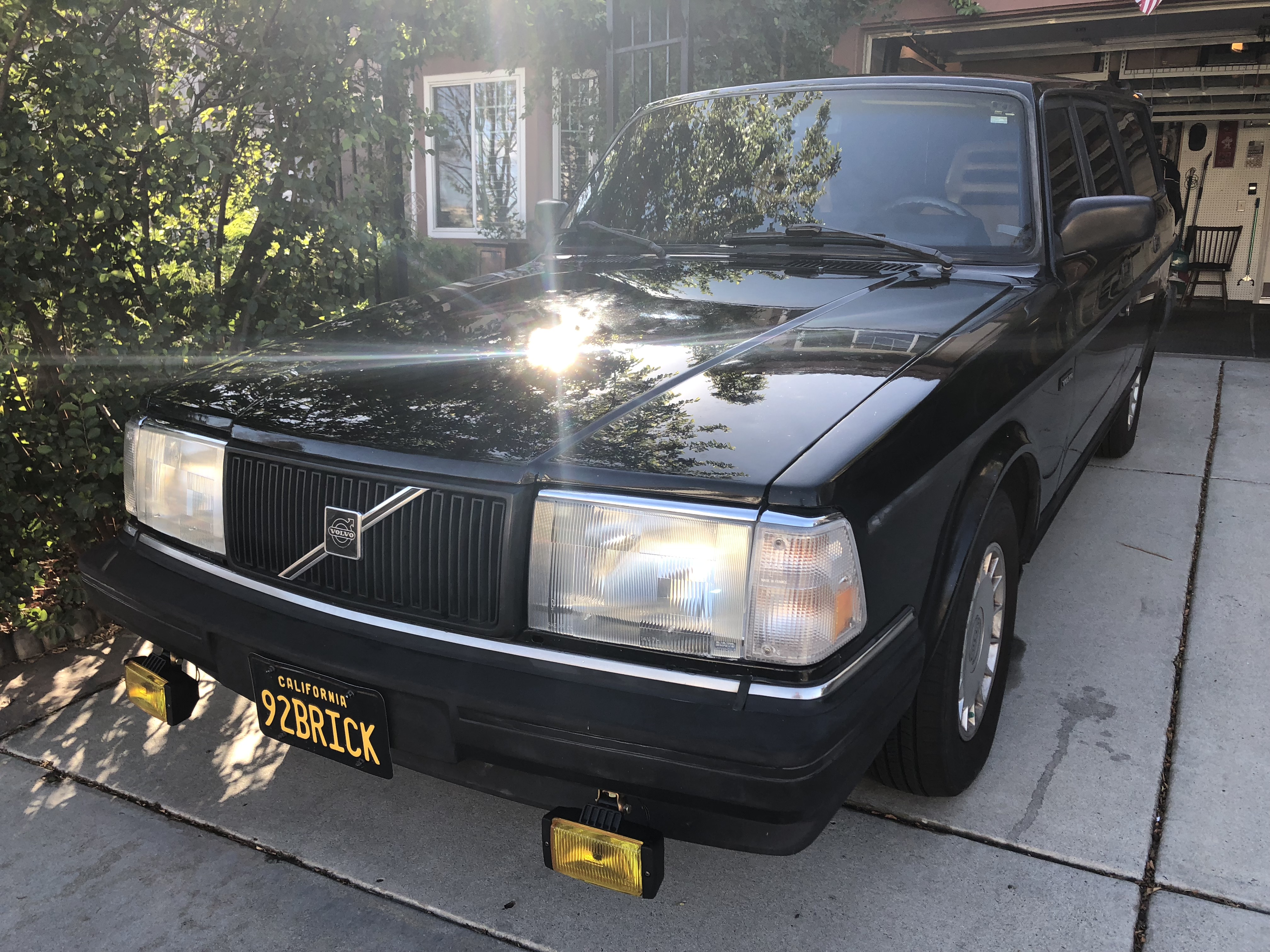

Hi guys, I have a pretty bad problem with my beloved 240 wagon. I had a lot of front end vibration/clunking coming out of the car recently so found a reputable shop here to take a look at it.
When they looked at it they said the motor mounts were shot, the drive shaft coupling needed replacing, the u-joints needed replacing, the rear springs needed replacing, and the rear sway link bushings were completely shot and there was metal-to-metal contact. I also had them replace the strut tower bushings/mounts and the fuel pump and filter. So, I spent the $1400 to have all those items replaced.
I went to pick up the car and it drove great...down city streets.
When I got on the highway, there was an obvious road vibration coming out of the rear end as I got up to 60mph. It reverberated throughout the cabin and a little through the steering wheel, so I drove it right back.
They called me a little later saying they felt the drive shaft wasn't balanced. So somehow it went out of balance after they did all the work? They ended up sending the car to another shop which added weights to the drive shaft to balance it.
I went to pick up the car yesterday and 70% of the vibration was gone, but it was still definitely noticable.
Can anyone tell me based on this info what they did wrong or could be the possible fix? They're having the car sent over to a tire shop to get the wheels balanced but I don't think that's it. It feels like it's something in the actual driveline. I know what an out of balance wheel feels like. Anyways, thanks for your help (again)
