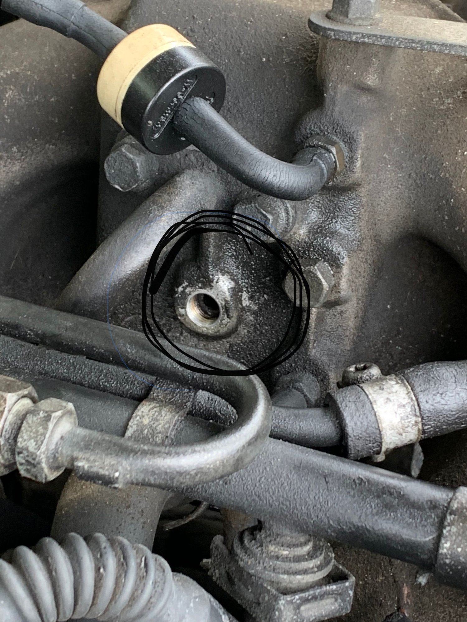

So the fuel pressure at idle varies from 36-40. When I turn off the motor the pressure slowly leaks down to 0 over about 20-30 seconds.

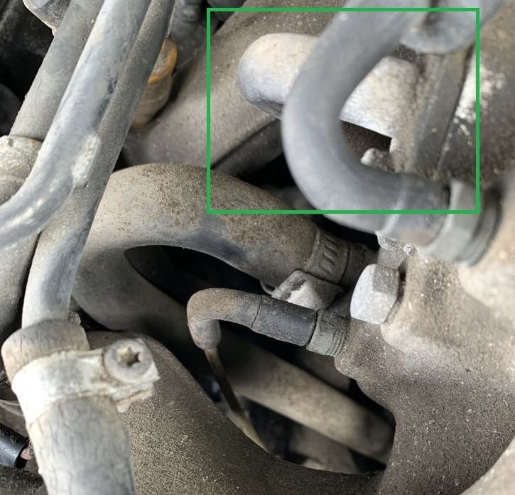

I noticed a suction sound coming from the intake manifold. Looks like this is threaded and there is something broken off inside.
When I plug the hole, the engine rpm drops. Is there a diagram somewhere where I can identify this orifice? I sprayed carb cleaner everywhere with this thing covered and the engine did not react.

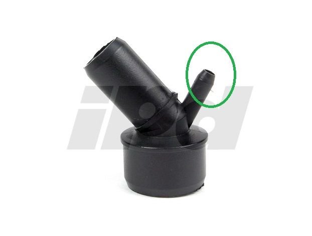

Is the brass nipple missing that connects a short vacuum line to the flame trap holder pictured below? That nipple is a metered orifice -

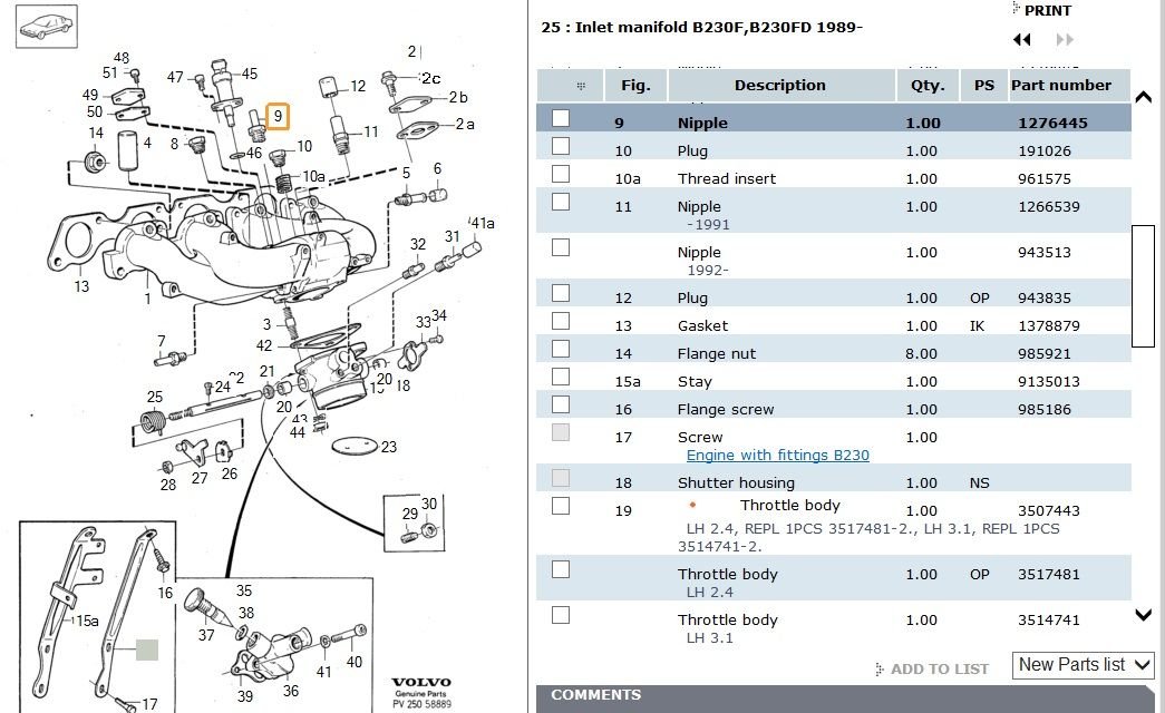

There is no fitting with a barb end. Are you sure that it is metered via the barb and not the insert that is inside as seen in the picture? That part is discontinued.

Yes the brass fitting is a metered orifice - I've cleaned thousands of clogged ones - usually with a small drill bit. vacuum line goes to the plastic holder.
On your manifold - there are two vacuum lines - top one would go inside the car for the vents controls, does that bottom one hook to the flame trap holder and what's missing is just a plug?

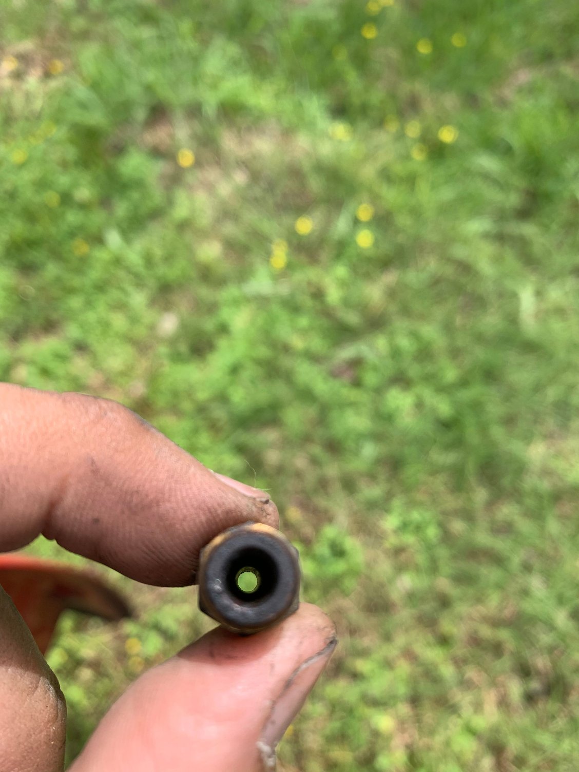

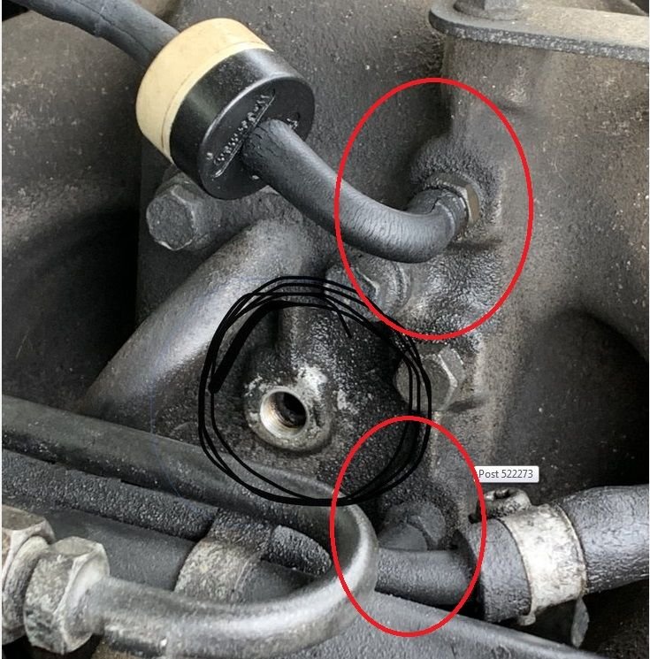

The other vacuum tube goes this part at 6 o’clock.
I found that the flame trap holder has no flame trap and the vaccum fitting is broken.
Got a barb fitting from a 240 at the junkyard and the orifice is wide open. The donor is a 1991 and mine is a 1992 so they should be the same. I can’t see how this is metered.

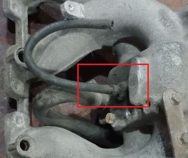

That looks like an EGR car, maybe a California spec engine. Did not see many of those in my part of the country.
The pipe into the manifold (squared in green below) is an EGR pipe - you will find it goes to a vacuum operated valve under the intake manifold and a pipe around the back of the engine to the exhaust manifold and the Vacuum line goes to your pictured switch and the EGR valve under the manifold to allow Exhaust gas back into the intake at certain times. (reduces NOX) The orifice is indeed metered - it's certainly smaller than the hole it screwed into!

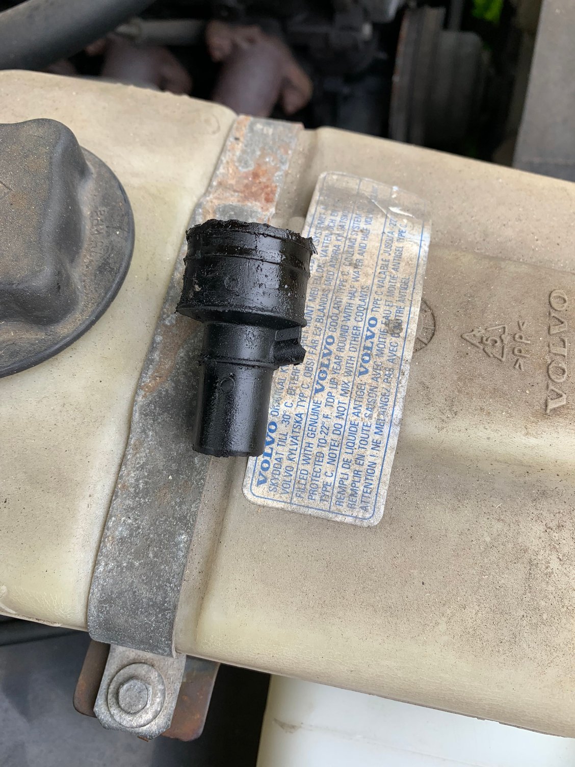

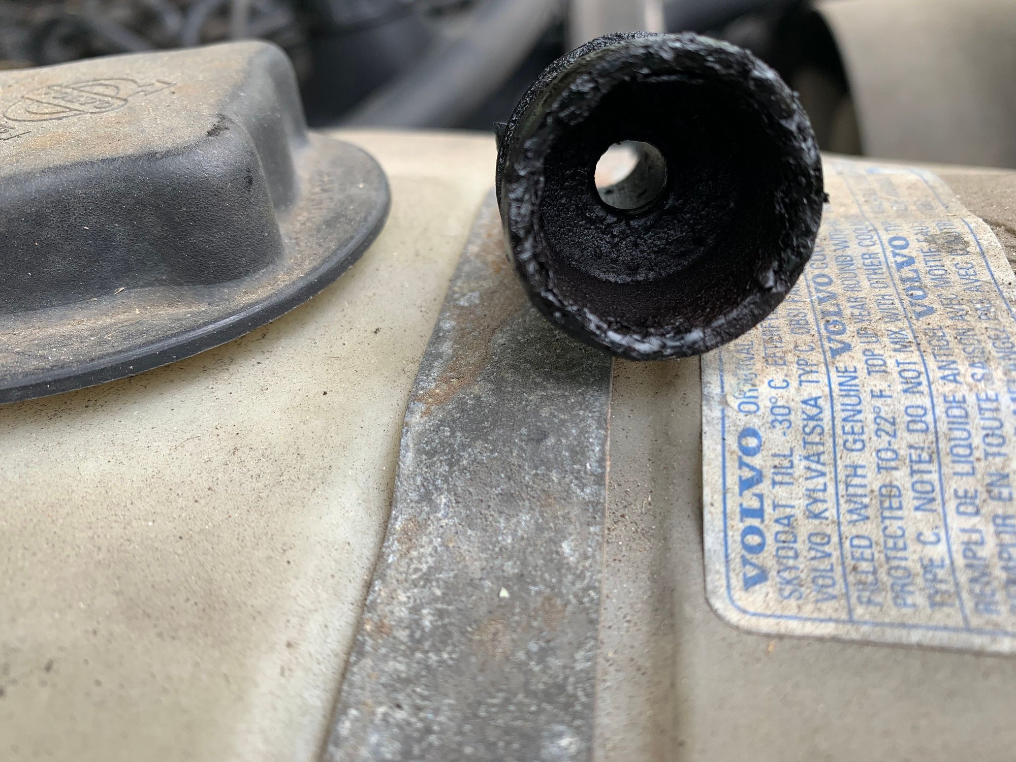

Ok got a replacement flame trap and holder and installed it. Car was a bit hard to start and idles a bit more smooth than before. No more hunting but still a bit rough.
After idling a few minutes it throws a 113 and 232 codes and smells rich, no smoke but rich.
The fuel pressure was about 38 and dropped to 0 after a few minutes after car was shut down on testing.
