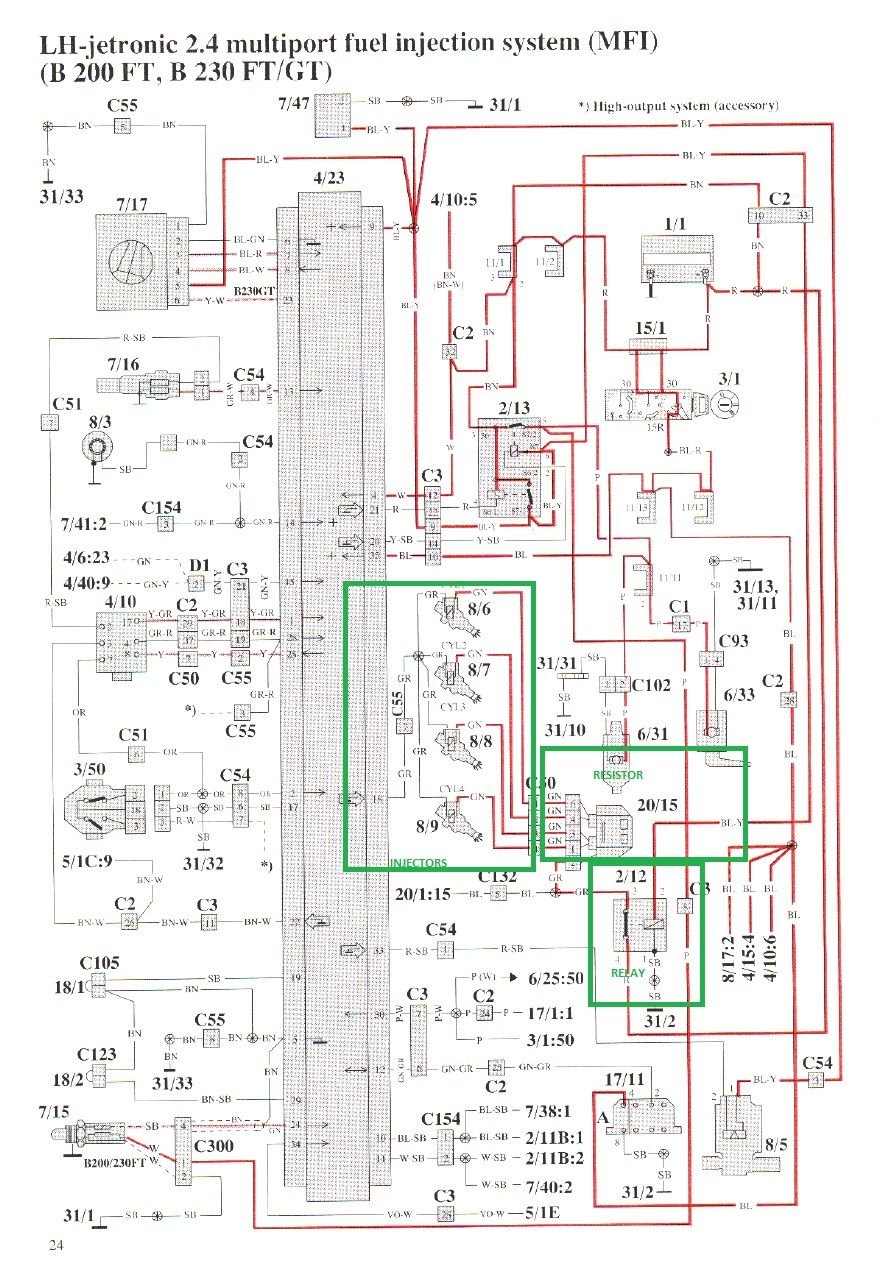

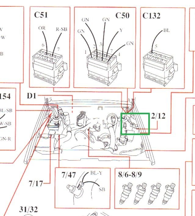

Your car has a noise suppression relay (2/12) that powers the injectors and commonly fails due to cracked solder joints - checked and resoldered? (black case relay with 4 leads near steering reservoir )
