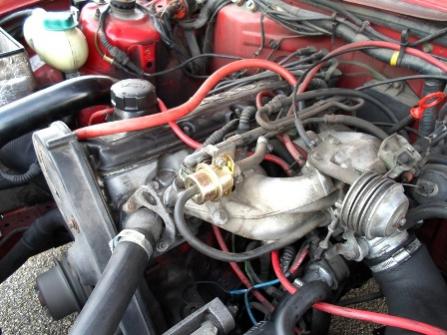

It lives! Lev, you hit the nail on the head I picked up a new fuel pressure regulator, and an under-car fuel pump. Tried the regulator first, as it was right on top, and it fired right up! I decided to go ahead and replace the pump as well, since I bought a new one and considering the mileage on the car.

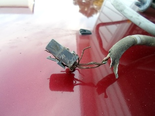

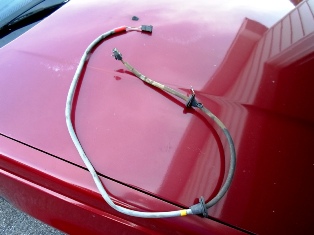

Before I got to the pump, I decided to replace the rotten speed sensor wire I discovered while poking about under there. That was easy and the original was rotted away and twisted together.
