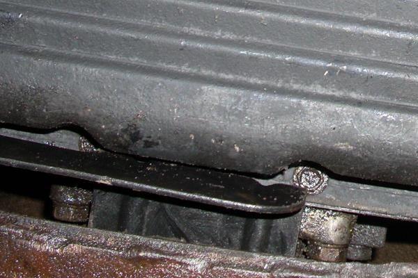

An exhaust bracket interferes with removing the last two oil-pan bolts. To reduce the total parts count in the vehicle, Volvo often uses the same bolt to attach two or more things. In this case, the exhaust bracket and the rear transmission mount. It was necessary to build a transmission cradle, jack the weight off the transmission and remove the mount. Later, getting the bracket back into place and the bolt holes aligned in three components simultaneously was very challenging.
