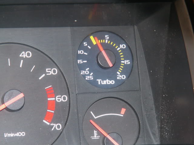

Default boost gauge question
Hey guys, im putting a boost gauge in the 740 and i had a question about where to put it. Any time ive ever put a boost gauge in a car its come with a "T" fitting and you just splice a vac line. This one came with a set of compression fittings and a bushing to install in the intake manifold. I cant find a place to put the bushing. Will I have to drill and tap a hole in the manifold? Thanks in advance for the input.
Old Sep 2, 2011 | 05:42 PM
swiftjustice44's Avatar
Joined: Aug 2008
Posts: 2,580
Likes: 9
From: Dallas, TX
Hmmm...your 740 already has boost gauge, why not just T into that vac line?
Old Sep 2, 2011 | 06:16 PM
hoobaguy627's Avatar
Joined: Aug 2011
Posts: 7
I should have mentioned that i have the non-graduated boost gauge on the car. The gauge that i bought can't use a t. It came with compression fittings and the vac line wont fit on a t. I also cant find any "Plugs" in the intake manifold that could be removed so that i could put in the bushing.
Old Sep 3, 2011 | 12:37 PM
Joined: Aug 2011
Posts: 7
OK, got the boost gauge installed via the factory vac lines and a little bit of fabrication using brass plumbing fitting. The 744 is an automatic and is pushing around 5.5 to 6 psi under full throttle. I don't plan on boosting it anymore until i get my stage 0-2 complete. I also want to swap the auto tranny for a manual. What is a safe boost after stage 2. I only want about 230-250 bhp, I'm not looking to turn it into a monster, just a quick classy ride. Thanks again for everybody's help.

Might want to give some more thought to a tranny swap. The AW71 auto you have is a beast...will handle way more torque than an M46 or M47. There's an accumulator lock up mod that actually helps the tranny; the clutch packs engage for a shorter time. The result is barking the tires in all 3 gears under hard acceleration. And...it's much easier to do burn outs with an auto. Assuming your plugs and wires are good and you run 93 octane, your car is good for 12psi right now. Volvo was ultra conservative. Depending on year, you either have a T3 or 13c turbo...both pretty much max out around 15-16 psi. Ditto the stock intercooler. To go any higher with stock i/c means you'll be pumping hot air. I added a methanol injection setup, IPD turbo cam and then larger injectors and 3" exhaust. On the 760, that's as far as I went under the hood. I was dusting stock 5.0 Mustangs routinely.
