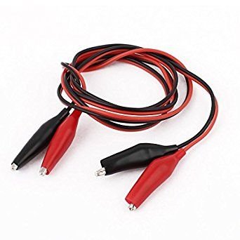

You could Be right but that seems a long shot. Do you know if what i descrbed i did - linking d+ line from alt to + post on battery is safe? Can i start the engine safely? I want to check that the key isn t a dud electrical link. Another wierd possible as i saw on yt vid is that the buttefly on intake valve isn t closing properly because of carbon deposIts this was the solution in one case. You d think auto zlone's alt test would spot a bad diode?
Hi Madman - just wanted to let you know I watched the video you sent the link to to test the diodes on an alternator. Simple! Still looking for a 'yes' answer on linking the D+ (tickler wire) on the alternator straight to the battery - to test my theory that the key mechanism may be the weak link in the current flow from alt to battery?
