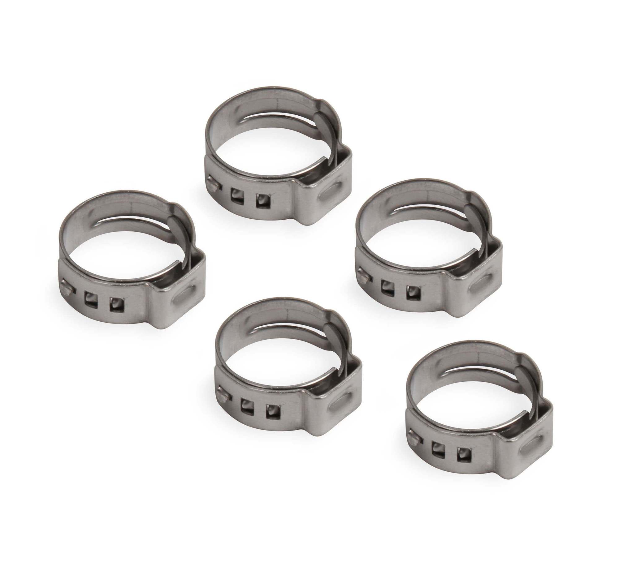

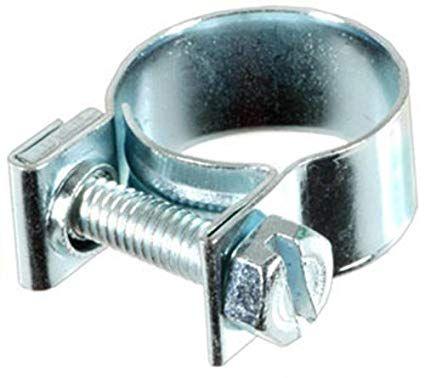

if you have to replace any of the fuel lines with 'generic' hose, make sure its fuel injection rated hose. and don't ever use the helical style stainless hose clamps on fuel injection lines, use either of these... the second ones need a special crimp tool, either need to be the exact right size of the hose.

Good advice Pierce. I used the second of your examples. I KNEW a helical type clamp would not be strong enough. I did use 'generic' line rated for fuel injection but it's not good enough as my engine wavers as the fuel line expands and contracts with the pressure.
