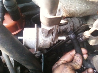

One line comes up and runs toward the passenger side of the engine just near the firewall. (Middle Picture) This line connects to the fuel injectors near the firewall and I can't figure out how to disconnect it to check for the flow of fuel.
The other line I was able to disconnect. (First picture from left) It connects to the injectors further from the firewall and closer to the front of the vehicle. It also connects to this rounded silver object that looks like a small fuel filter or something - see picture. I disconnected this line right where it connects to this filter object, and while a friend turned the key, I watched to see if fuel came out. NOTHING. No fuel came out of the hose after trying several times. Does this possibly mean clogged line between the back and front of the lines?
Also, how do I get the first fuel line to disconnect to check for flowing fuel?
Also, if the line is just clogged should I just replace it?
Lastly, there is a picture where a small hose connects from the intake to that small filter-like object. (Picture furthest right) This hose I realized was cut badly. Could this be why the car did not start?

Since you asked, I'll say what I know, (which may not be much) Anyways, the little silver round thing is a fuel pressure regulator. I'm pretty sure fuel should not come out of here when the pump goes on, it goes the other way when the pressure is too high, hence the name. That fuel line you cannot get off is where the fuel flows. As far as getting it off, I do not know.

Oh, and as for that line going to the FPR from the intake, it might not start because the pressure is not regulated. Defiantly worth replacing anyways.

Yes, that was the fuel pressure regulator, you pulled off the vacuum hose which as stated, should have nothing come out of it. Be careful with the other end (fuel supply from pump), it looks like a rubber hose, but that's only to protect the nylon hose inside it. I know because I cut mine off thinking it was simply a piece of black rubber fuel hose. I was never able to get the hex fitting off the injector rail, it's on there for good... Without the vacuum hose connected to the regulator, I'd expect the car to start, but have driveability issues due to the unregulated pressure. There should be 45-50psi with no regulation, a bit less with the regulator working and connected. It's unlikely you have a clog in the fuel lines or that little vacuum line.
