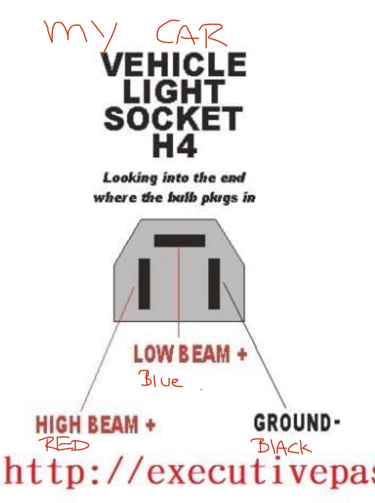

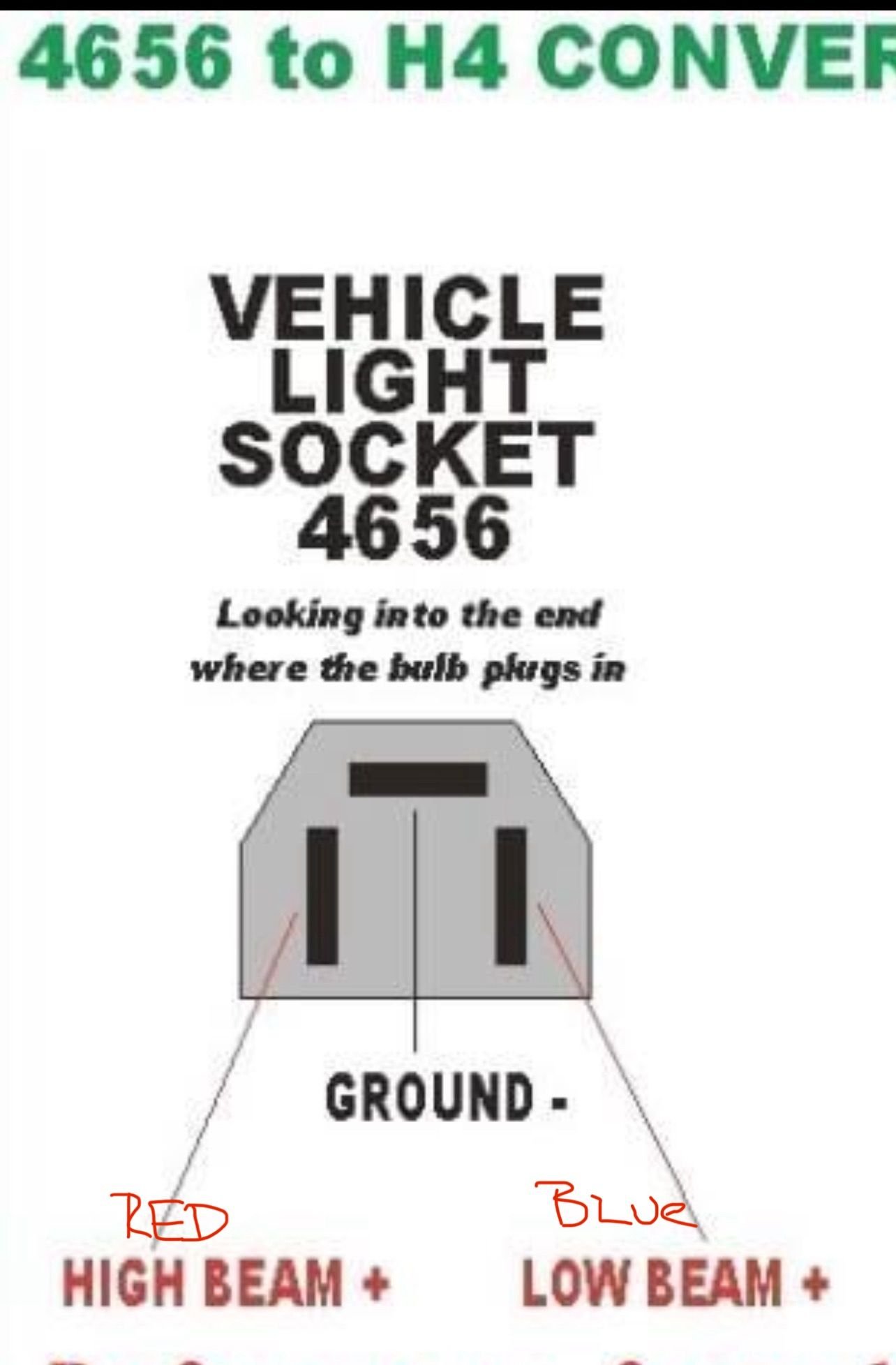

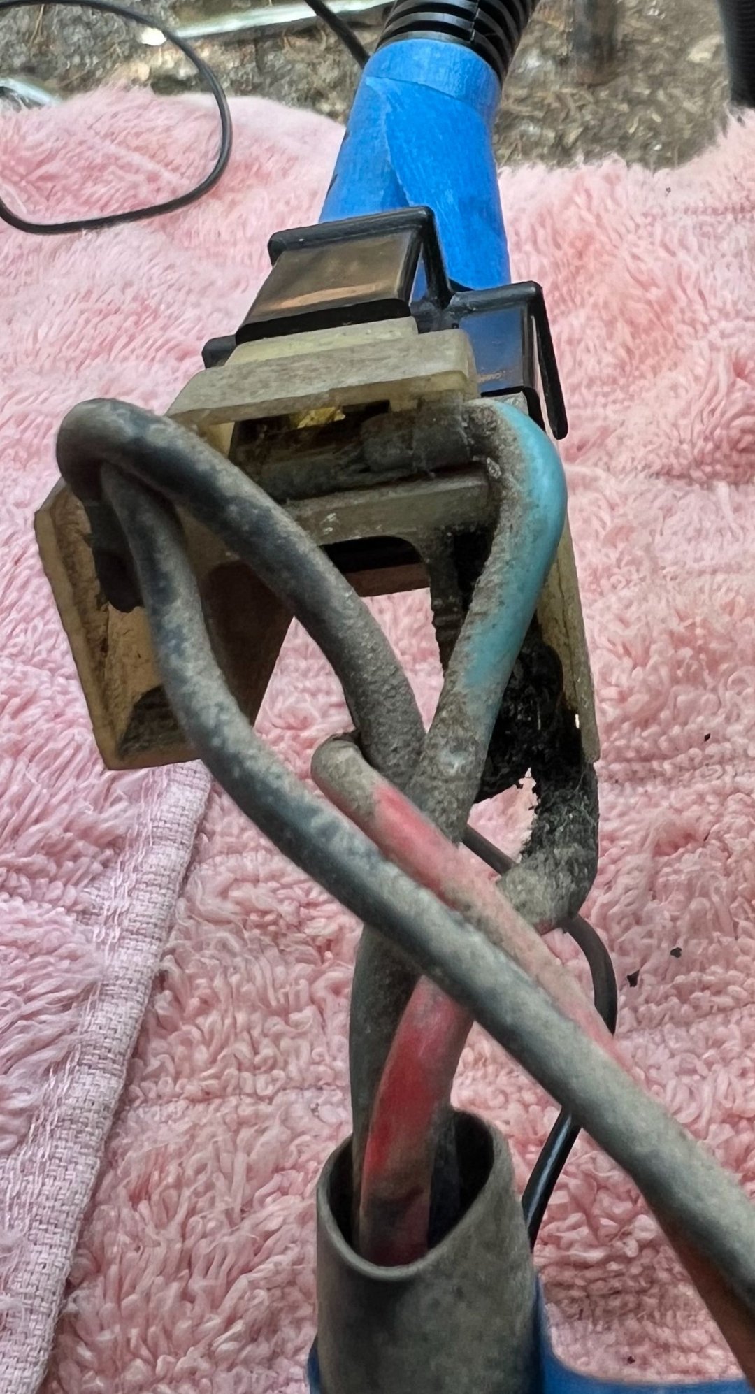

I have a 1978 quad round 244 with sealed beam lights. I’ve heard these older cars can have issues with the switch overheating and melting? Anyway- I assume the original pin position of this car should be set up for 4656 style socket?

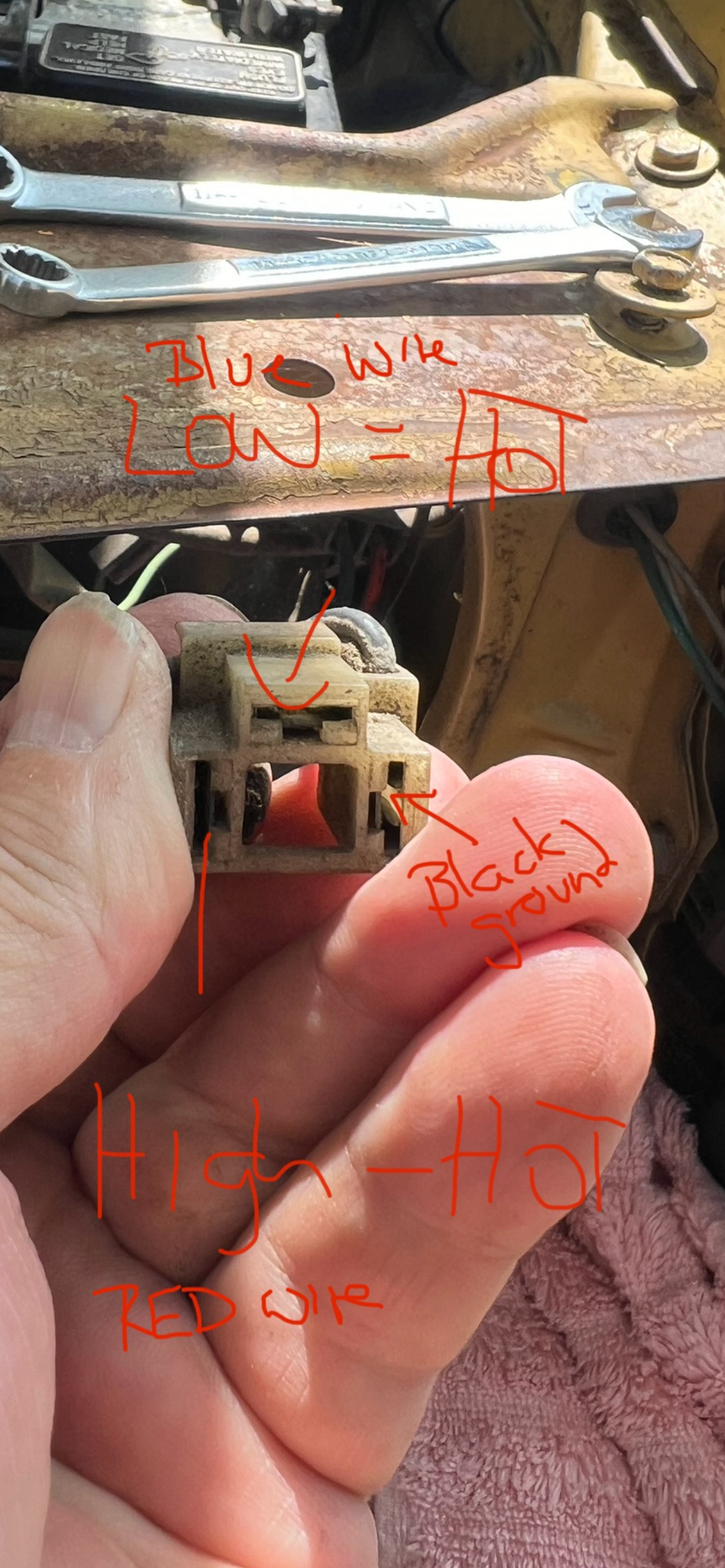

Front of the drivers side high/low plug seams to suggest that this car has an H4 socket set up?- and not the 4656? The top ( low beam)and bottom left ( high beam) light up with my tester when either is chosen. Can anyone confirm that this wire arrangement is correct/ standard- or should the top and bottom right pins be switched to mirror the 4656 light socket?
