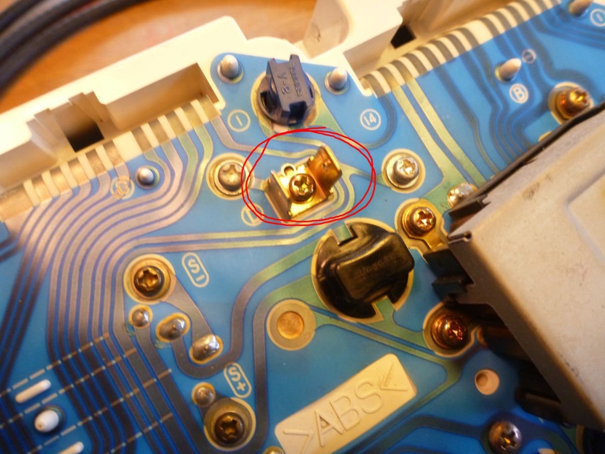

it's a metal case with one screw in the middle. That small case/box has four legs with eyes which is screwed to the flexible plastic circuitboard on the backside of the instrument cluster. Relay i thought it to be if not, how would you call that metal box? Dimmer regulator case?
like here:

One of possible causes - thd thermal fuse on 'relay' pcb. When you disassemble it from instrument cluster and open metal cover, you will find there small pcb. Gently take it out, find fuse (black rectangular thd element) if it not conducts, lights will not go on. Fuse is 3A, 115 deg C, 250V. When installed bulbs excedes designed ratings components might get hot and thermal fuse will do its job. This is single use element, so it must be changed for new one.

Just wanted to say a quick THANK YOU for this info about what's in the grey box. I discovered the thermal fuse , which had in fact blown replaced it and restored the display lights! Yeh!
